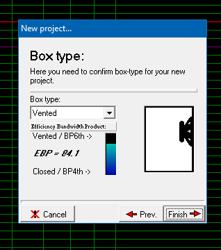

When I added this driver to WinISD and brought it up to calculate the box volume, it showed a very strong preference for a vented box.
It would do, if you used the high voltage (listed as 'vented') Q values that the OP stated he was using, as you evidently have. With a Qt in the mid 0.4 region, a Vas lurking around 150 litres & an Fs of 37Hz, its fairly typical for vented box loads, or sealed if you want outright power-handling rather than LF extension.

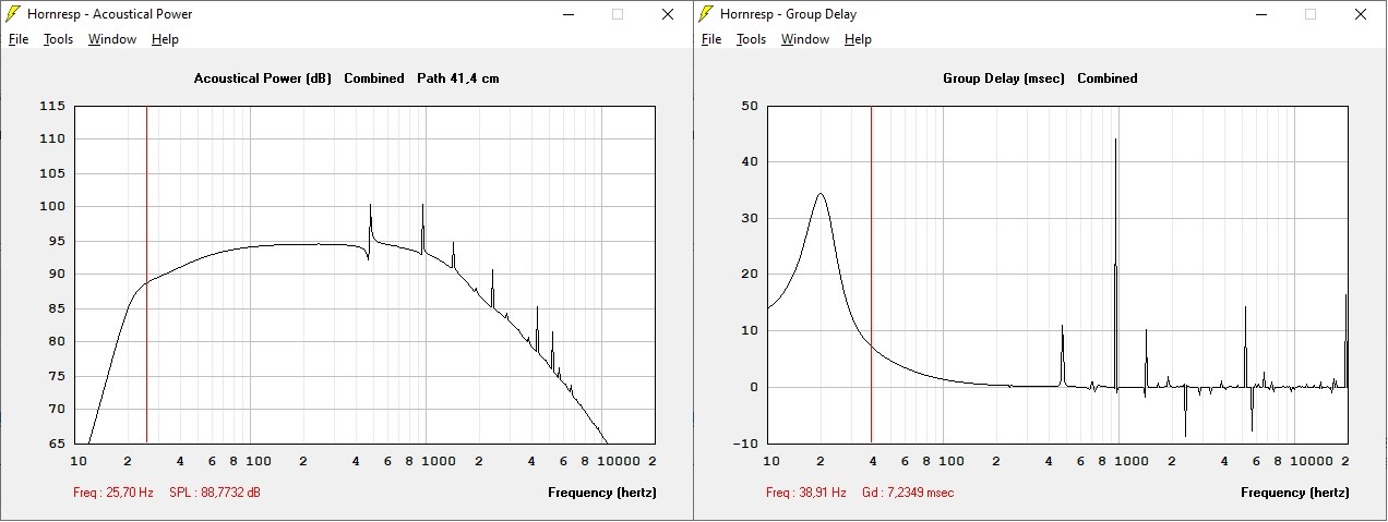

Well, it depends A LOT on the form factor, If you build for instance a cube of 163 liters you can get very nice response (see picture), going that low will limit max SPL a bit, but that might not be a huge issue for you.
The short of it: The more you squash the boundaries together towards classic tower structure, the more resonances will become troublesome.
A huge cube or even better: sphere, is a much better starting point towards battling resonances than the classic tower.
