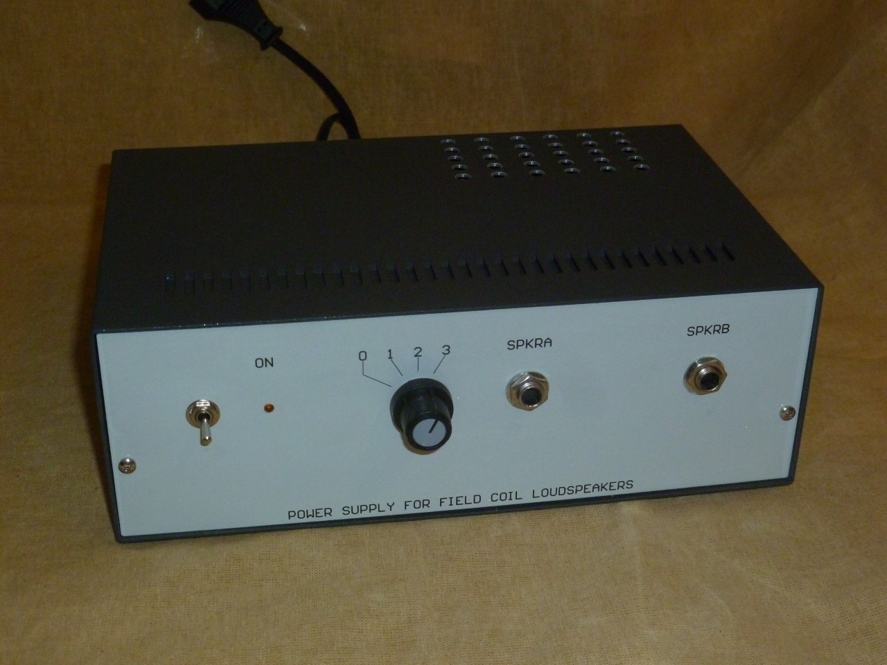

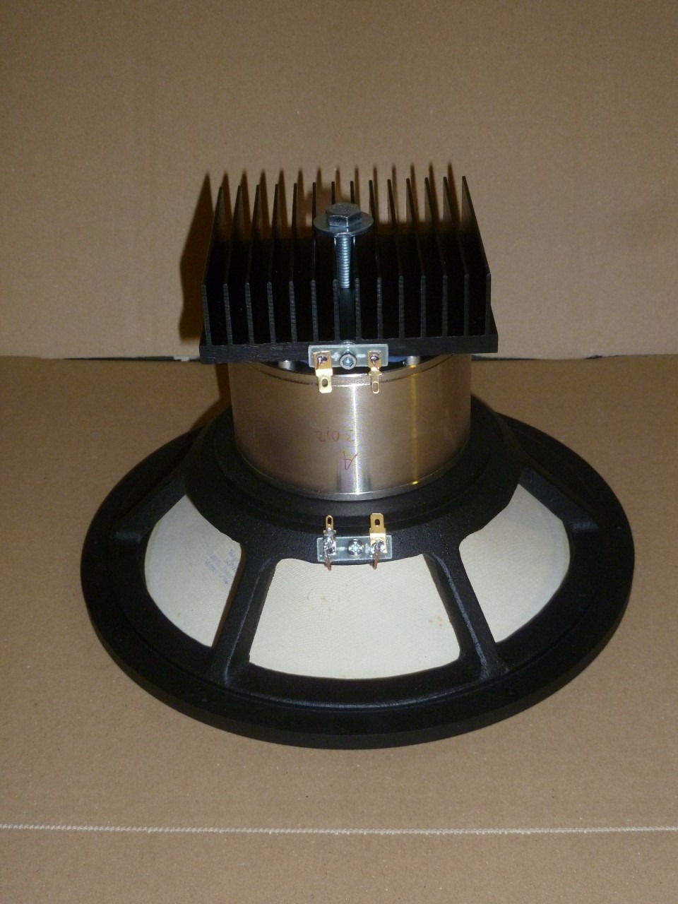

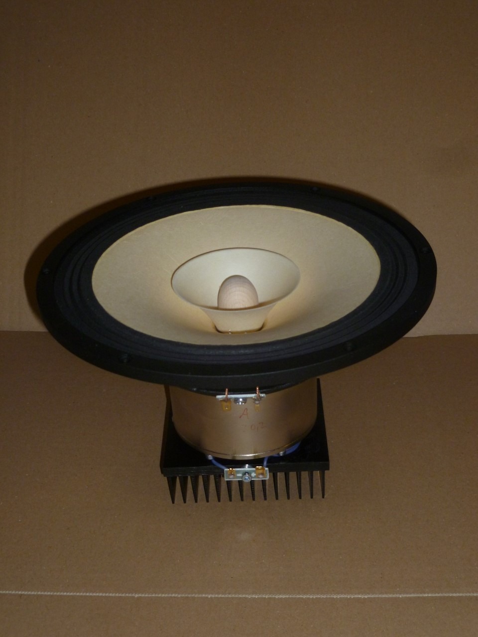

What are the capabilities of the field coil? And how is it built?
I would test it out with a range of magnetising currents and listen to what they do to the sound.
AFAIK the core should be strongly saturated. This should reduce distortion as it prevents the VC field from storing additional energy in the core. But there could be other effects at play, like air leakage or the domains aligning differently depending on the field strength, possibly resulting in some kind of sweet spot, or the harmonic balance changing...

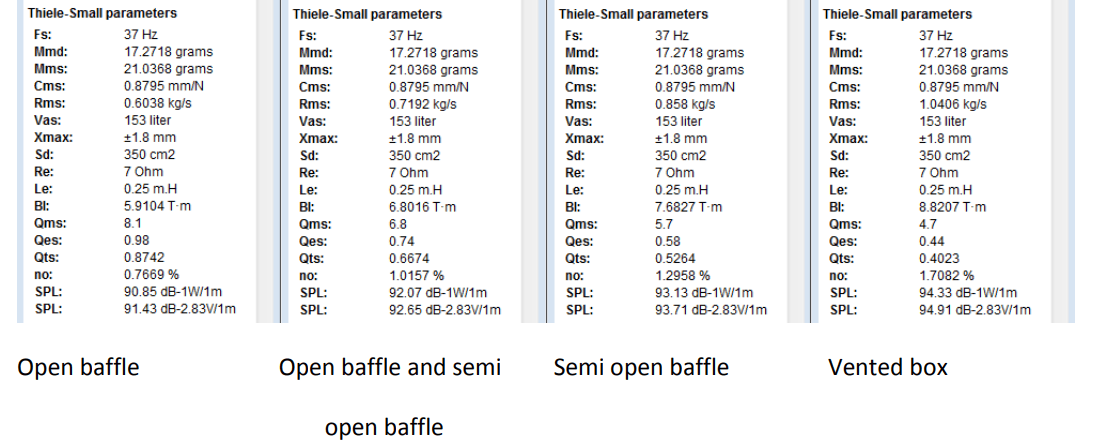

And 6cu ft? Why not hop on Hornresp and play around with some rear loaded horn alignments? You could also play around with the BL curve and see what effect it has on response peaks there. Though there might be some overlap with tinkering with the output resistance while keeping BL steady.
As noted above, it doesn't require 6ft^3; assuming the highest voltage drive (lowest available listed Q), then optimum power-handling, with a reasonable response, is just over 106 litres, or about 3.75ft^3.
Typically, a back-loaded horn is the largest of all possible enclosure options for a given tuning, assuming a reasonable response, although to a point that depends on how you define the response & of course it's assuming the same tuning (& that all the box types can achieve the same -a horn theoretically can get lower, at the price of size).
