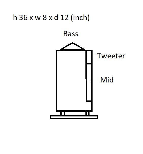

I am not sure I understand but just to show what I am thinking about, this small drawing.
Everything is hollow inside and the bass goes trough the bottom of the speaker cabinet tube.
