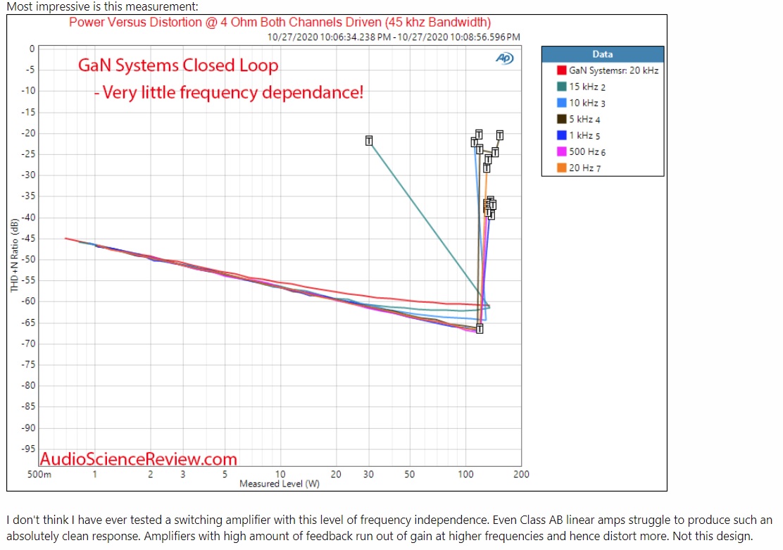

It looks interesting the GaN amp and could be the "next cheap TPA3255 that is better".
The frequency independence is definitely better than any Class-D.
The implentation on this amp review is not good but promising.
https://www.audiosciencereview.com/...tems-amplifier-eval-board-measurements.24202/
This is the GaN Systems module curve for their Eval board.
The Mini Gan and the Orchard Audio measure better.
Yes as my link say...
