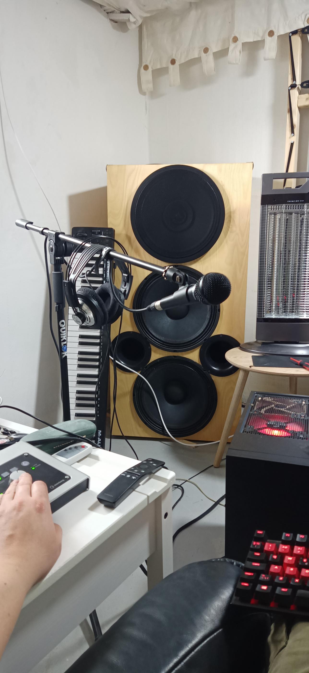

That was part of the motivation for getting into the Pascal power amps and balanced DSP setup fed with a proper soundcard featuring a proper knob to adjust volume. Who needs a remote anyway.
If you're willing to pay the price of two Hypex 502 it is possible to get about the same quality and perhaps better, for less.
In my view I got better (chasing low noise levels) and paid about the same, so it's all good.
I use a different soundcard now than the one in the picture.
