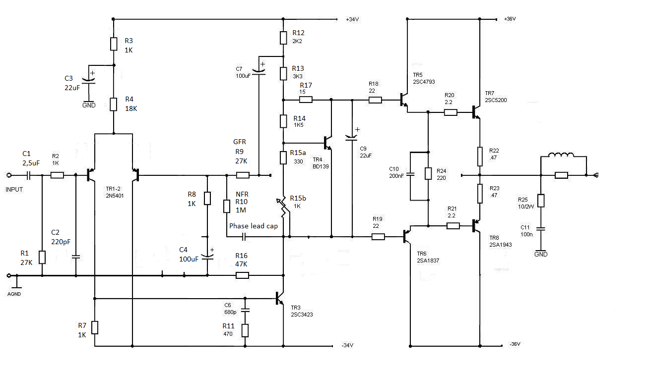

Hugh, thanks. You are a teacher for many of us who are hobbyst.
Now another question, I think compensation is missing, I consider it a Phase lead. The capacitor may be in parallel or in series with resistor nested. Any changes in the R9 and R10 relationship?
Very clever, Guillermo!
When you introduce nested fb with a LTP input stage, you skew the output offset and it's difficult to correct it. A small ceramic cap in series with the nested fb is effective, and I would suggest 10nF. This is NOT a phase lead cap, however. It's a DC blocker, nothing more. A phase lead, around 10pF, would be across the 1M resistor, if needed. This approach restores the offset at the output node, keeps the LTP nice and balanced, yet introduces the nested fb. Significantly, at very low frequency the nested 'cap' does not pass much AC current and the amp operates at full global feedback, very nice for driving bass signals. The cap comes in at 1khz and higher, delivering the benefits.......
BTW, what is your idea of using 47k shunt from VAS collector down to ground? I think I know what you want here, but not quite sure. Valery has suggested this too, I know what it does, is this your intention?
Hugh
Hugh

Hugh, doesn't that mean that the ratio between the feedback from the two loops is 31dB, rather than the total feedback being 31dB?
The total feedback is the ratio of the // value of the two values (1M & 27k IIRC) to the value of the R to ground (1k) so the total feedback is something like 28.4 dB.

You find that the nested fb regime does change the harmonic profile and in fact increases the H2-H5 levels whilst reducing the H7 and beyond.
Hugh
This is something I have noticed in sims. The effect is present whether you have plain resistive shunts or nested feedback from the VAS outputs.
Been thinking that there is no reason to favour resistive shunts over returning the resistors back to the LTP negative input. You get two benefits this way. The first is you still load the VAS output to GND via the feedback shunt resistor. The second is that you get nested feedback for the IPS. This is getting dangerously close to MIC compensation?
From what I have read, you actually want the resistors taken from the VAS output and not from the (pre-)drivers. This was a bad idea from my part. VAS loading is a pre-requisite for this to work. Unlike normal compensation where
taking the pick off point to the next stage after the VAS can be an advantage.
Is my understanding ok?

Hi Jan,
Yes, that is what I mean, the gain (OLG) is very close to 31dB but it is not the same. We have agreed the series fb resistor is 1k754 (taking account of the nfb resistor of 68k), and the shunt is 68R. Therefore the gain is (1.754+0.068)/0.068 = OLG =26.8 ie 28.56dB. Now, when we examine the comparison between global fb and nested fb, we have (1.8+0.068)/0.068 for global gain, and (68+ 0.068)/0.068. Clearly the ratio drops out the 0.068 shunt fb resistor (and the shunt cap) so the ratio of global v. nested is (68+0.068)/(1.8+0.068) = 36.44. If we ignore the shunt resistor, as it is small, we introduce an error (3.67% in fact) and if we use 68k/1k8 for 37.77, we are a little higher.
Consider this in a conventional amp: Normally we have a very high OLG from the input+VAS stage of around 90dB. If we set CLG at 28.5dB (26.7), then the usual figure of global feedback (loop gain) is (90 - 28.5) = 61.5dB, a usual figure at 1KHz. If, however, we impose some nested feedback with a 68k/1k8/68R network, we reduce the OLG open to the entire amp, though it is available to the 1st and 2nd stage, and therefore delivers a superior performance, fidelity, THD and output impedance, to the output stage. But the negative feedback available to reduce the output stage is now much reduced; the factor of ratio of the nested ratio to the CLG.
Figuring out these relationships if you ignore the output stage decompose to the standard relationships of any amp with feedback since the output stage has approximately unity. I always meant this, but was trying to cut down the math. But we agree and are not talking at cross purposes.
Yes, Paul, I believe we agree. If we set VAS collector with resistive loading to ground, we reduce the loop gain. This worsens THD, but has some benefits, although driving impedance of the drivers is probably not one of them. Correspondingly, if we set lower loop gain by loading the collector VAS back to the fb node, we can achieve the same thing, but now we have the benefit of lower THD at the output of the VAS, and lower Zout to drive the output stage. Equally, the loop gain could be the same. Question: Which sounds the best - without regard to the total THD amp figure? I will leave that to you.......
Hugh

Hi Hugh,
This I shall discover soon. Fortunately, my latest amp's PCB is ideally laid out, by chance, to enable easy modification between the two options. My technical mind tells me that returning the resistors back to the FB node is best but reality may be different...
Another variable in all this is LTP degeneration. One of my observations is that THD is lower is you reduce the loop gain via loading of the VAS output rather than use excessive LTP degeneration. This is obviously done while keeping loop gains around the OPS equivalent to make it a fairer test. Always wondered why and now it is beginning to make some sense. Think I am observing the benefits of the lower VAS Zout etc?
Paul

Yes, I fully agree with the calculation & method and such.
I would however question the desirability of allocating more loop gain to the 1st and 2nd stage to the detriment of the output stage. As see it, it is the output stage that is the limiting factor of the overall feedback so I would rather allocate more loop gain to the output stage.
Jan

Very interesting discussion! Let me think a bit more with regards to the global/nested loop gains proportion ...
Guillermo - your calculation is right, it's just 1M looks very high at a first glance - my bad 🙄

Very nice to do feedback on the VAS, but it has a limited drive capability.The feedback resistance snoops away a part of the drive for the output stage and is an extra load that make the gain of the VAS smaller allready.
Mona
Mona
True, but would you agree that the two bases of the complementary drivers load the VAS too? And a complex load too, rather nastier than a single resistor, and besides, you could load it with 1Megohm, as GEIrin has shown us........
