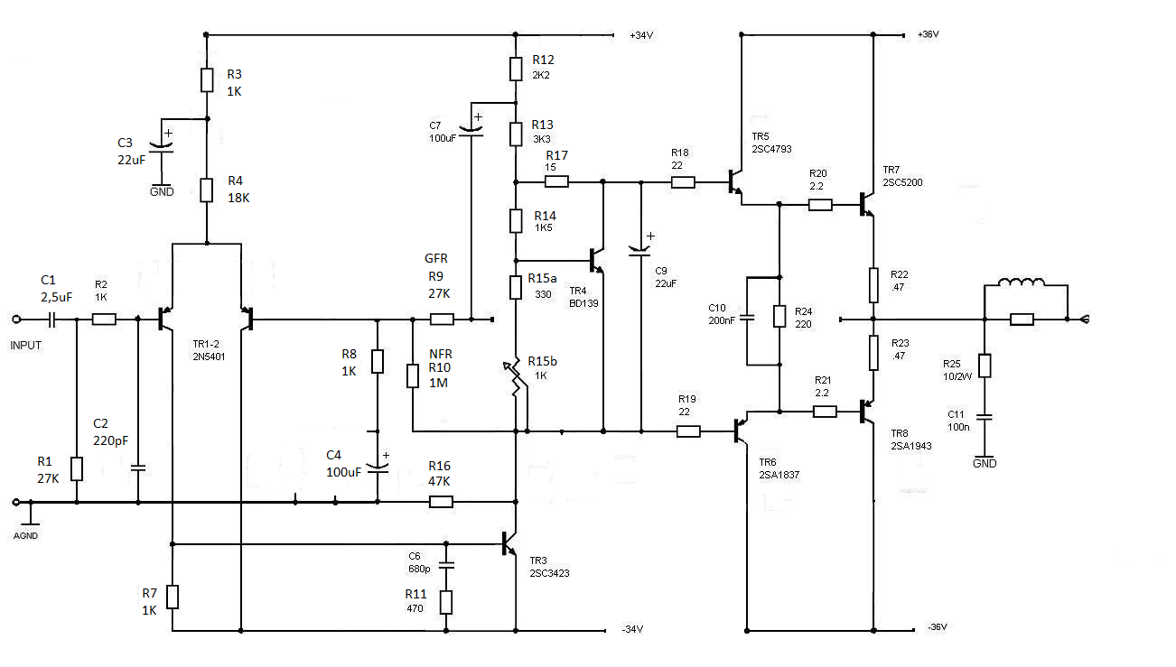

To date have been using resistive shunts to GND from the VAS output to reduce loop gain at lower frequencies. However, just recently, have been looking at the feasibility of returning these resistors back to the LTP feedback node instead. The thinking being that this could be make use of the feedback being wasted by the resistive shunts. Then I thought this feedback could come back from the drivers (2EF) therefore reducing VAS load. It all works but can't see any real performance gains in LTspice.
Can't help thinking I'm missing something??

The main reason I'm using the VAS load resistors, referenced to ground - OPS input impedance shaping.
In BJT OPS, especially EF2, input impedance changes extensively in sync with the output current change, increasing distortion, especially IM. Assuming the VAS is designed for being capable of driving the higher load, those resistive shunts decrease the influence of OPS input impedance variance.
in my experience, nested feedback - assuming the loop gain around the OPS is decreased - works best with low-distortion OPS topologies / builds. I used it with my non-switching OPS.
In my case - internal feedback loop additionally loads the VAS stage and decreases the loop gain over OPS at the same time, providing slightly less control over the speakers.
Overall subjective effect - more pleasing bass representation.
It's deep, "velvet", elastic and less "dry" at the same time.

Jan, here is the thing - one of the causes of IM distortion is OPS input impedance CHANGE. This is a dynamic effect, a pretty complex modulation.
Making the load higher (impedance - lower), but more constant (less modulated), we may slightly increase THD at the low end, but decreases dynamic distortions, like IMD, in the whole audio range.
Which is more important, to my taste.
There are many other ways to stabilize the input impedance of the OPS - use CCSed drivers, add one more follower in front of the drivers and tame the additional phase shift (and shunt it again, but with higher value load)...

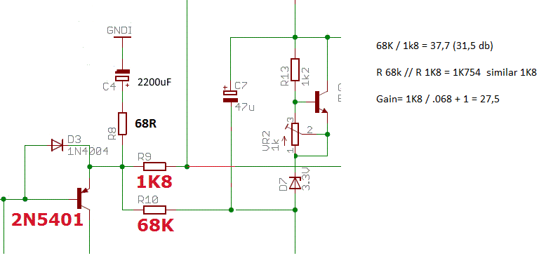

Better way is to use VAS gain for decreasing VAS output impedance (and linearity) simply using local NFB in VAS , resistor in hundreds kohm (in series with e.g 330n capacity) parallel to Cdom.
Right, but you can also make the loop wider - just put that resistor between the VAS output and the amp's negative input. We come back to nested feedback configuration then - lower VAS output impedance plays its positive role again.
After reading the various post, here is indeed a definition of the value of R10 according to Hugh. R = 1M. It will be OK?
