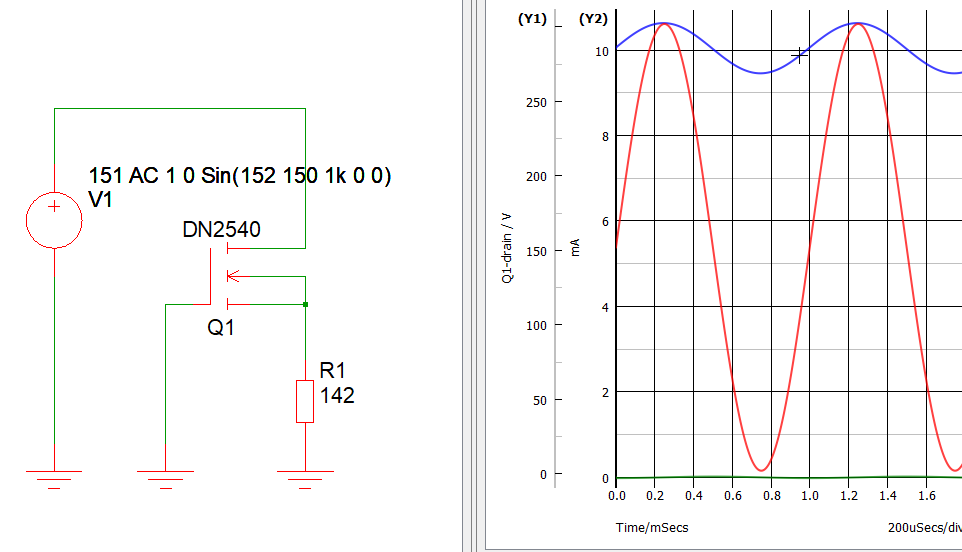

A 200 Ohm resistor as Rset between Source and Load yields 10mA current sink. As I demonstrated above, the noise is a fraction of the LM334 and temperature dependence is de minimus.
DMOS are quite variable so one has to use a potentiometer for the correct Vgs(t) to arrive at the correct value. SY first pointed this out in his articles "Impasse" and "His Master's Noise". Nothing original to me!
Walt Jung, in response to communications re his AX articles "Sources Part II" agreed that these active devices, while benefitting impedance, resulted in much higher noise.
The original circuit can not work.

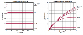

The DN2540 needs only -1.2V at the gate to sink 10mA. LM334 needs 1.1V typ to sink 10mA. these are typical values the FET might only need -0.85V.
no headroom left.
But when you replace the LM334 with an adjustable 150 ohm resistor you have a stable sink with maximum compliance and minimum noise and cost.
