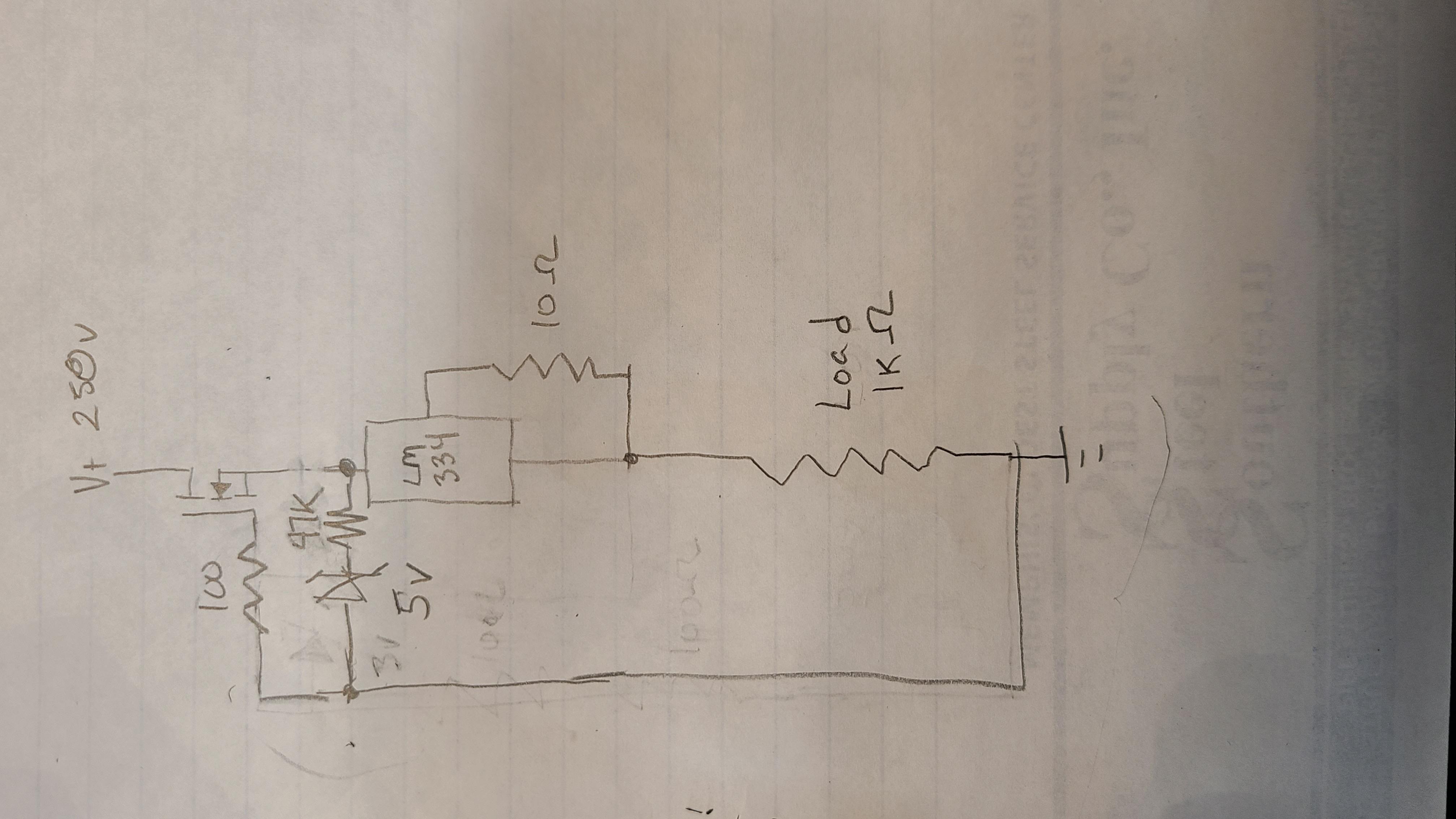

Ok, if someone could look this over before I start letting the smoke out of components again.
If I am not mistaken, I will need the 47k resistor to limit the current (5mA) through the Zener, otherwise it will be shorted to ground once the source voltage rises above Vz.
I just don't think that is going to work. As I reed it you will have the gate of that mosfet tied directly to ground through the 100 ohm resistor. That will keep the mosfet off and no curent will flow through the rest of the circuite. Now i have been known to be wrong but I kind of think if you power it up it won't blow up it just won't do anything. But as I said I could be wrong.
I hope you didn't use that wrong schematic all the time ... the load shouldn't be connected inside but the CCS has 2 terminals and the load is from the minus side to ground .
Like this for sure the G-S max voltage would be exceeded easilly as the load + LM334 is in parallel .

The one from the link I provided or the schematic I’ve drawn?
I have the load connected to the V- terminal of the LM334.
My uncertainty involves where the gate should be connected. Rod stated I should add the Zener to protect the gate of the MOSFET, unless I misinterpreted how it should be connected.
The gate of the Mosfet should be tied to V- of the regulator , not ground .
In the link the schematic is correct , but that is for sinking current so the load is on the other side between + and the drain of the Mosfet
If you want to generate current you put the load from V- and Gate to ground .

Yes, it is an active load for the plate of a 6SN7, so my previous tests had the load connected to the V- terminal, and the gate is connected to ground through the gate stopper.
OK , now you know the problem 😀 , the good part is that is not a design error and could work if you do it right .

I'm not sure if I'm over thinking something, or I still lack something in my understanding of the operation of the circuit.
If the gate is tied to ground (directly or through the stopper) it is now at 0v.
The source will be at the supply voltage of 250v minus the drop across the FET.
So my Vgs is -250. The zener as drawn, really isn't doing anything. I will just have 5v at the cathode of the zener. The source will still be at ~250v and the FET will die from exceeding Vgs(max).
If I connect the gate to the V- terminal of the LM334 (which is also where the high side of the load is connected) with the zener across the source and gate, the FET doesn't die, but the LM334 isn't doing anything. The current just changes with applied voltage. Makes sense because the zener+resistor are just in parallel with the LM334, and has a much lower impedance than the '334. Is there a way to provide gate protection with the zener that avoids this?
I'm about to the point of scrapping the whole thing and just dealing with having to manually trim a FET cascode with a pot, or just hand sort them for Vgs. Again, the point of using the LM334 was to eliminate the variability in Vgs between examples of the FET.

I think my problem is related to how the gate is connected in the circuit.
With the gate tied to the high side of the load, the zener provides a current path around the LM334.
If I tie it to ground, then the zeners provide a low impedance path to ground around the load. It "works" when simulated, but even if they are in series with the gate stopper to ground, there is still a high amount of current flowing through this path, much greater than what my supply is capable of providing.
Any resistance high enough in series with the zeners to limit their current to a manageable amount just ends up dropping a lot of voltage across said resistors and leads to a high Vgs.
Just really stumped on a solution right now.

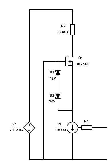

Usually it would look like the attached picture, where R2 is the load/circuit you want to pass the constant current through.
edit: ps. I quickly drew the circuit using an online schematic creator.

FWIW, I tried that using back to back 12V zener diodes and my MOSFET still blew up. That's why I went with a TVS diode.
I used one of these... SA12CA - SA Series - Leaded TVS Diodes - Littelfuse
Have you tried using a 10M45S instead? They're a lot less finicky than the one you're using. The TO-220 version is pretty cheap and they are robust. Just use a 1k resistor on the gate and a 300r resistor at the source and that'll give you a clean 10ma CCS that works up to 450v or so.
