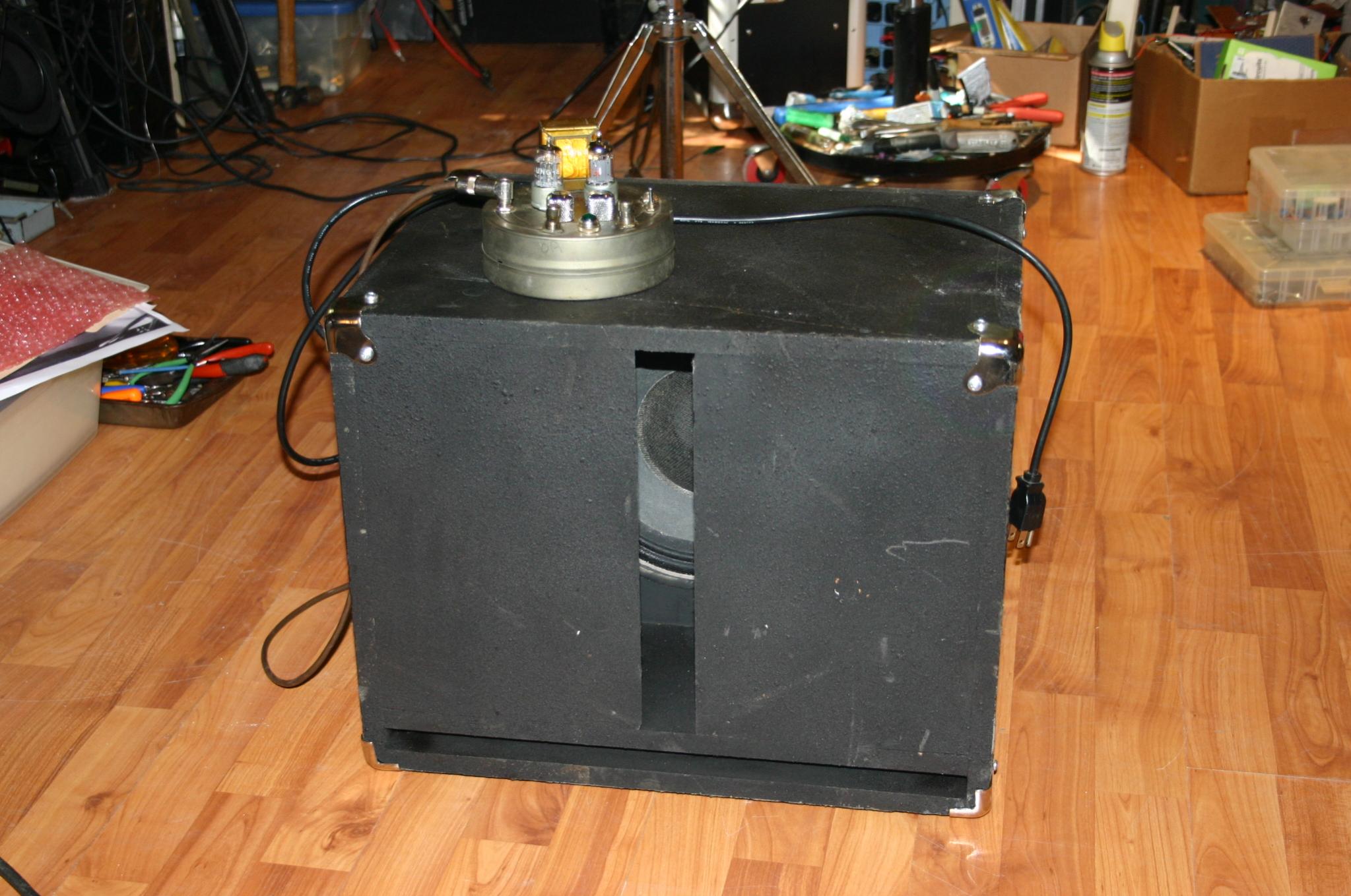

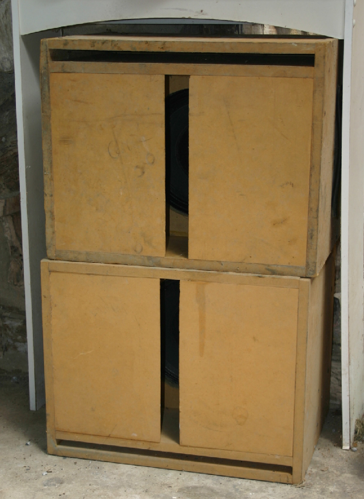

I built these years ago and thought they may fit in the tapped horn family. Remember nobody seemed to know the origin of the design back then.
They are resonant @ 110HZ (A2) and noted would blow out a lighter, the one with a 1.5" front baffle, it would do it 12 ft away.
Loaded e'm with Eminence Kappalite 3010HO's and used an ICEpower300ASC, they really seemed like some kind of air pump.
Any info or history of this design would be appreciated.

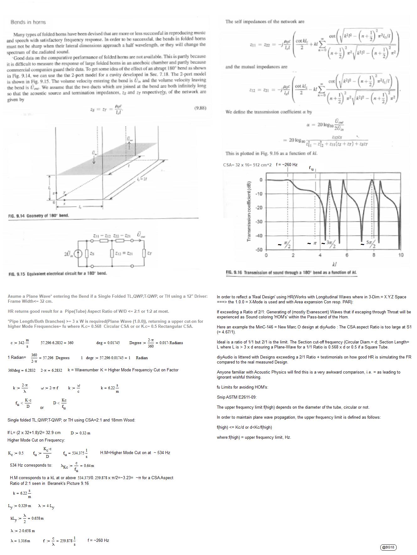

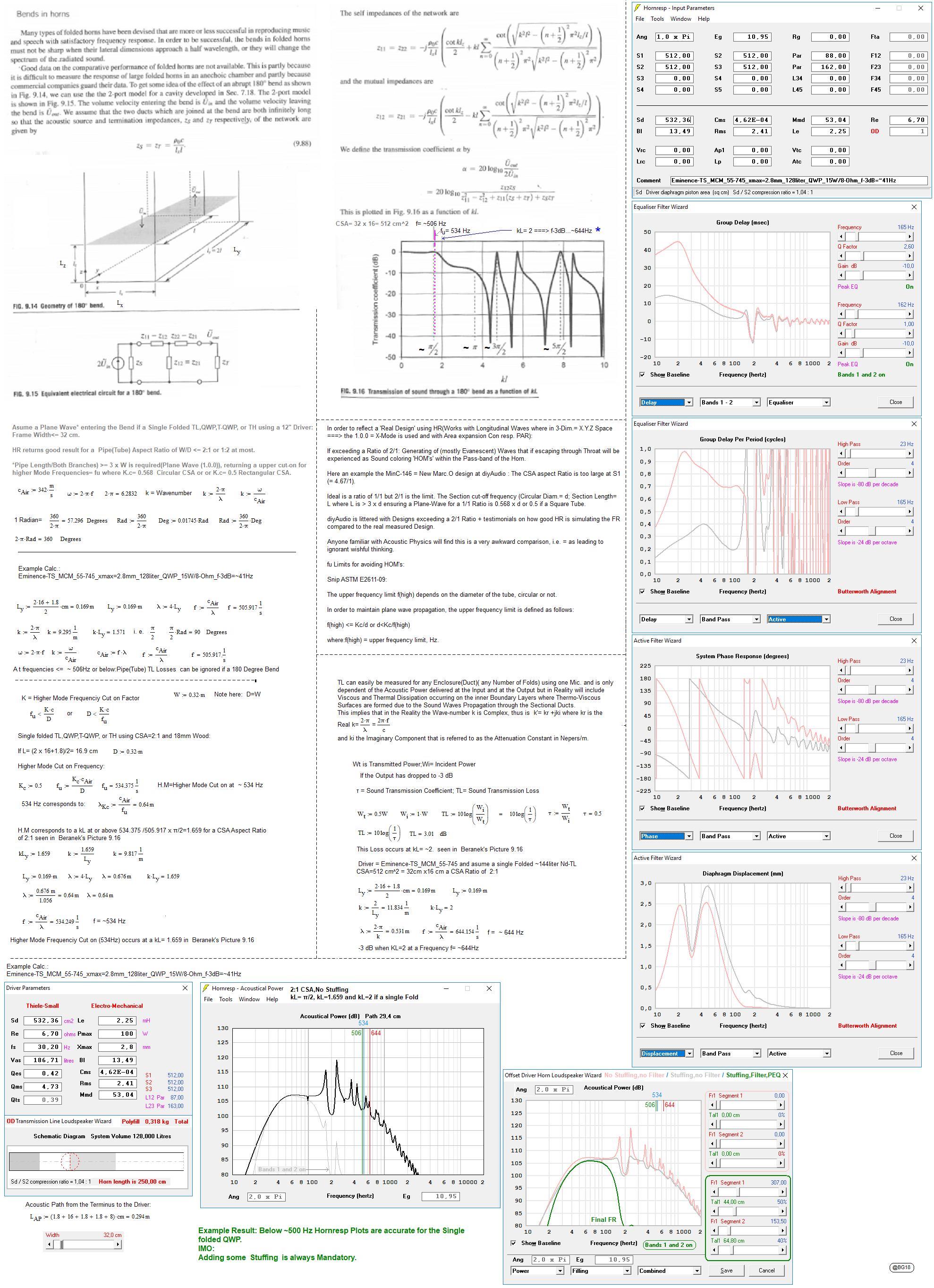

Hi All,
Discard the Picture hereabove.
Picture Update: Made a more readable One + Edited the Calculation Errors I found due to unintentional Variable mixing (Easy to overlook in MathCad 🙁).
b🙂
