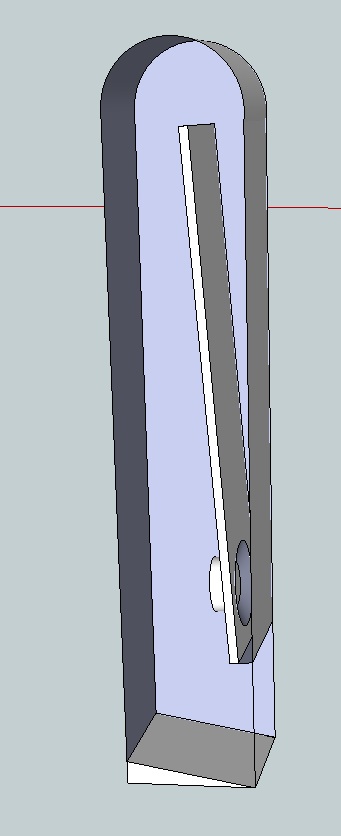

Fewer bends make cabinet construction simpler.Something like this MaVo...
Is there an advantage / disadvantage to fewer / more bends?
Fewer bends result in a long thin box, often better for hiding in the home, laid down or standing up.
More bends can result in a more square box, better for stacking in a PA.
It is preferable to do more bends at the throat end and less at the mouth end.
The example you showed has a rounded end, a superfluous detail that wastes internal cabinet space.
Build the box out of 3/4" plywood, brace it well.
