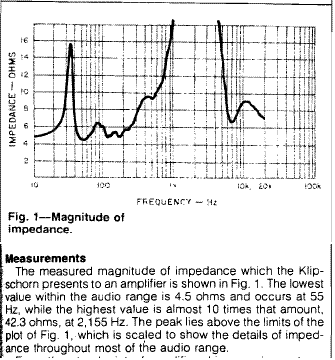

Hi Ben,I have run motional feedback with great success with my Klipschorn (want to call that "gildng the lily" of woofers?) and so I mentioned it............ When it is not orderly, you obviously can't use motional feedback to smooth the response. Pity.
Can you show us the 'orderly' impedance plot of your Klipsch?

Impedance of complete Klipschorn.
Response of Klipschorn bass unit only.
Hmmm, I thought we were talking about low subs not full-range from 10 to 20kHz?
Dirty pool to show those curves and esp. to choose to include that misleading caption as well. "Scoring points" or helping the discussion?
Ben

Dennis (djk) graciously answered Djim’s question placed to you, “Can you show us the 'orderly' impedance plot of your Klipsch” in post #29.
I’d say that’s helping the discussion.
The charts he posted show the frequency response response of the Klipschorn bass unit only, and the complete impedance graph clearly shows the impedance peak centered around the 5 dB 75 Hz dip followed by a series of peaks rising some 20 dB above the passband response the Klipshorn exhibits.
The TH designs of Djim, myself (and dozens of others), and the PPSL BR designs of djk all have a smoother response in the bass pass band ( around 125 Hz and below) than the Klipschorn bass unit.
