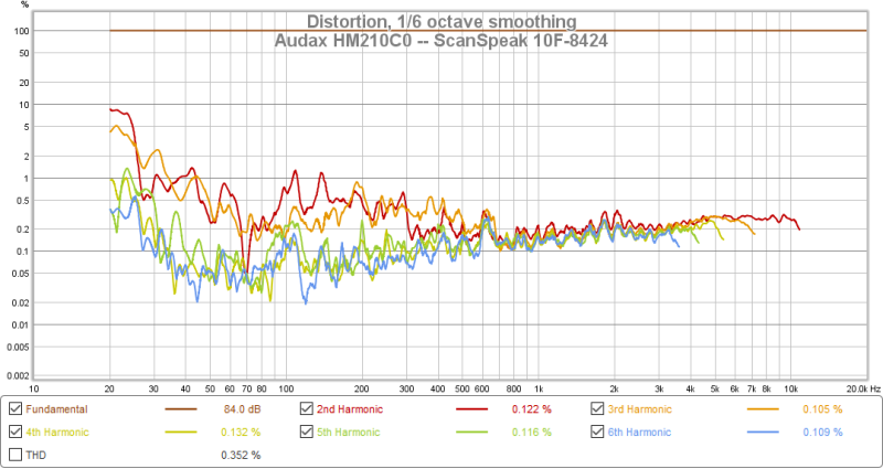

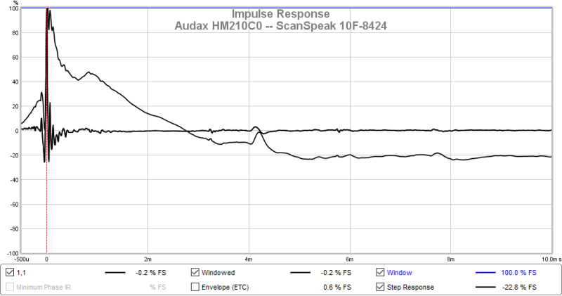

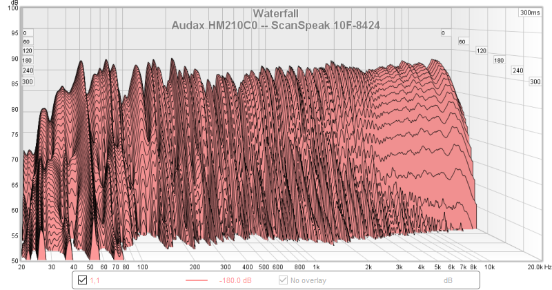

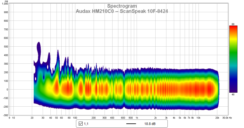

I finally got some time to play with the cross-over for my Audax/SS FAST speaker. I wanted to keep the XO below the telephone band so I placed the XO at 300Hz, however, this is just not possible with a 3" class driver. The 300Hz XO did work quite well at the Dallas show, but the 10F was working way too low and that shows in the distortion plots at high SPL. So I tried again, this time at 500Hz. The natural roll-off of the 10F still shows in the tail of the high pass, but it is now significantly lower in frequency and the driver is not working nearly as hard.
I included the target plots that Byrtt provided and I got a reasonably good match. As it turns out, level matching the drivers is extremely important to getting an acceptable FR plot once the tweeter is time delayed. I wound up lowering the tweeter 1.5dB, which is why the tail doesn't match the target exactly.
Trying to get decent low frequency data in a home environment is next to impossible, so I did not try to smooth out the woofer FR, I just made the tail match the target. This is good enough. Trying to take the room modes out a 1m is pointless since the room modes at the listening chair are totally different. My technique is to use the "output" PEQ's to tailor the low pass tail, then use the "input" PEQ's to handle the room modes from the listening chair.
These speakers have the cleanest sound of any I have built. The main reason is that the two drivers have very low distortion. Except for a very few minor peaks, the distortion stays below 1% until below 30Hz. While my drivers cost twice what the drivers in the other XO thread currently running, you do get what you pay for. There is no comparison in the distortion plots. Will my speakers sound twice as good? Probably not, and the sound of the FF85WK is very different from the sound of the 10F, but still....
It is unfortunate that I rushed the cabinets to completion to make the Dallas show. I did a rather poor job of the veneer and finish, so these cabinets are destined for the fire pit. The replacement will likely be a three-way: Dayton RSS315HF-4 16-80Hz, Audax HM210C0 80-500Hz, ScanSpeak 10f-8424 500Hz up. I might even gild the lily with a rear firing super tweeter crossed with a single cap at what? 20kHz? I'll never here it, but hey!
Bob

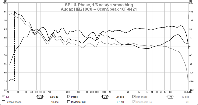

Just for grins, here is the phase response of the Audax/SS speaker. Very close to minimum phase.
Bob
.....These speakers have the cleanest sound of any I have built. The main reason is that the two drivers have very low distortion. Except for a very few minor peaks, the distortion stays below 1% until below 30Hz.....
Great it sounds build got into a very good speaker system, sense the same thing myself when combining 10F a German Kevlar woofer.
.....Just for grins, here is the phase response of the Audax/SS speaker. Very close to minimum phase...
Think that is not for grins but serious good phase response from 2-way IRR speaker system, could even imagine if you push button "Estimate IR Delay" into REW than phase track above 5kHz would track even closer to that IRR frq-response minimum phase ideal, thanks sharing nice speaker and data.

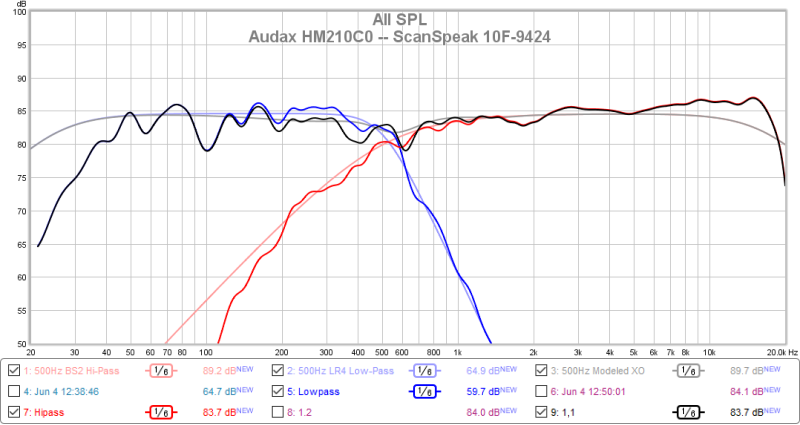

Hi Bob,
Thank you for sharing this design.
One thing caught my eye: look at the region from about 200 Hz to 1000 Hz. The sum of both drivers should be greater than the individual responses everywhere in that region. Currently, in some places the sum is below the individual driver responses. This indicates that the phase of the individual drivers is not overlapping in this region. What this means is that as you move up and down from the midpoint of the two drivers, you will get peaks and nulls at different frequencies.

Bob is using the Harsch XO - a characteristic of it is that the sum is less than the bass by itself. That's actually how you know it's working. Best way is to look at phase plot. It will be approximately flat with a soft rise by 55 deg at the xo frequency. The response actually oscillates by about 1dB through the xo region. That's normal.
http://www.diyaudio.com/forums/multi-way/277691-s-harsch-xo.html
Here is theoretically what it should look like - notice the squiggles and how it's less than woofer by itself?
I will post in the XO thread, not here, about the Harsch XO. Why would you optimize for parameters other than the frequency response? Not only will there be ripples on-axis, but similarly uneven performance will manifest on other axes. This is a very poor trade-off to get an improved step response.
Not a poor trade off at all in my opinion - if transient perfect or quasi transient perfect is important to you. Once you hear it - second order LR with upside down tweeter sounds not so good anymore for percussion and plucked strings when source is recorded well. What's 1dB of ripple? The phase is linear with a mild rise - that's better than a phase wrap going through 180deg.
@ra7
1. Have you actual heard a transient perfect XO? Listen to the difference in makes in attacks.
2. I could care less about off axis, as this is a single listener system. I only care about how it sounds at my chair.
3. You will never hear hear the minor ripples. Remember that your brain fills in voids, and there are no peaks in this XO.
Bob
