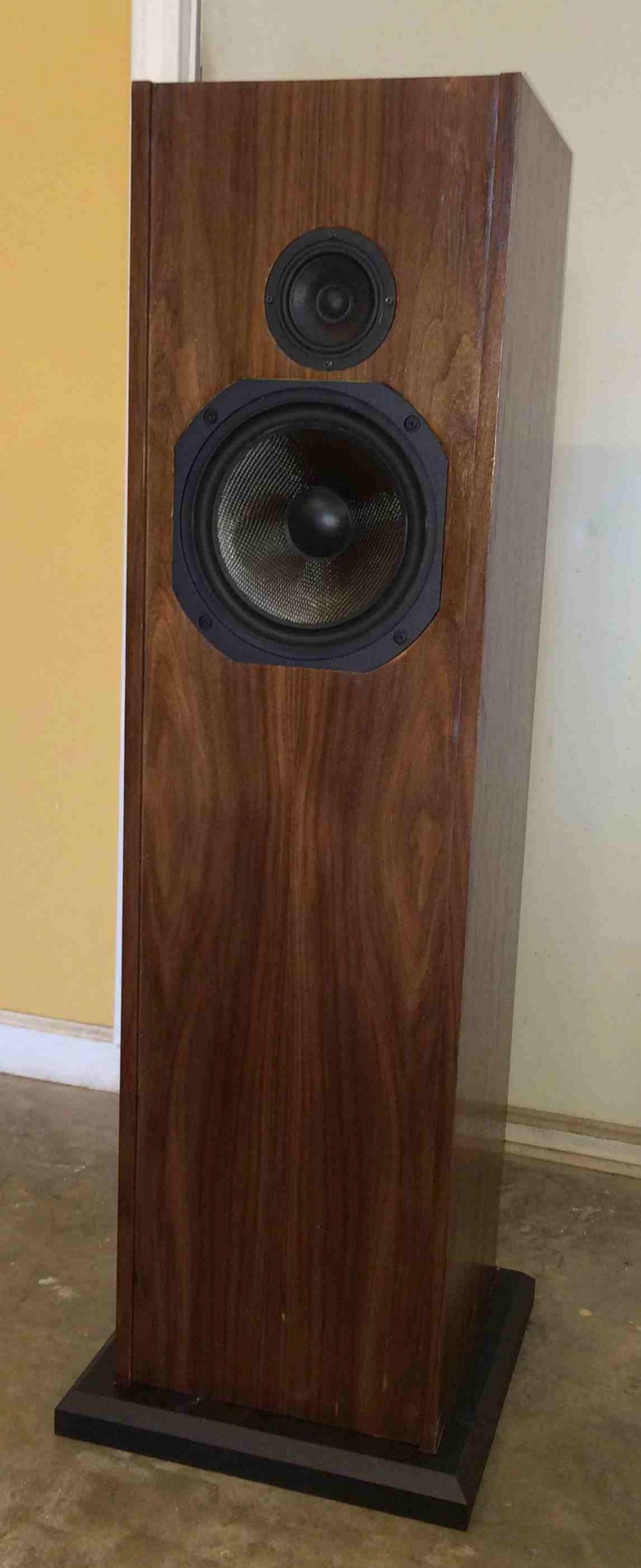

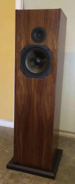

My Audax/SS speakers have just completed a 100hr burn-in and are sounding quite nice.

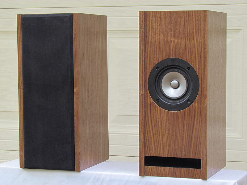

I had a pair of P7's in the test mule that became the T7-A7 TL. With a bit of time on my hands, I decided to make them presentable and bring them to LSAF. I built up one side where the panel was a wee bit short of flush and slapped some Bondo in a router accident. Then I went looking through the scraps of veneer left over from other projects. Ah ha! I have enough kewazinga to cover these little guys. $45 drivers, $250 a sheet veneer. Perfect match.
I haven't got a picture of the little TL's since they just got their first coat of tung oil varnish this afternoon. First picture is the Audax/SS MLTL's and the second is the production T7-A7 with A7.3's, both in walnut.
Bob

Bob, I hope you separated and protected the SS from the Audax inside that cabinet or you may blow out the SS. Wouldn't want you to make such a mistake at the show.
Just kidding of course. Those speakers look really nice and I'd love to hear them. Good luck showing your stuff!
The SS's are in 4"x12" PVC pipes. Once enough stuffing is added to smooth out the resonances, it doesn't matter if the pipe is open or closed. Mine are closed. Next time out, I will use a simple sealed box behind a mid-tweet.

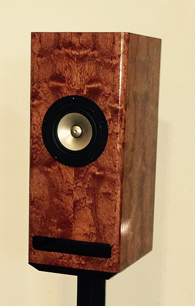

The little guys are out of the paint shop. The veneer was sold as kewazinga, but that is by definition rotary cut babinga. However, the veneer appears to be plain cut. Anyway....
Driver is the MA P7. My initial impression of the P7 is that it has a bit less character than the A7.3. Not necessarily a bad thing. I will need to do some A/B comparisons to come up with a genuine opinion.
Bob
