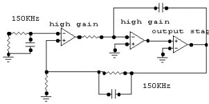

OK, I played with nested loops in the past and prototyped all Cheery circuits. While the idea is appealing, it required special forward path for the implementation. I’ll explain:
1)inverting output stage with gain. Not that simple as emitter follower, slow discharge of output devices – common mode current spikes.
2)single output from the input stage – use of current mirror, again extra complexity, all this additional devices in forward path represent their own minor poles/phase lag.
For the conventional forward path: single-ended input stage, voltage amplifier stage and output follower there exist only one loop – from the output to the input of the VAS. But this loop is less stable than conventional Miller compensation. If you would like to utilize differential output from the input stage there is no possibility to arrange nest at all.
So, once you start to spread wisdom here 🙂, what was your solution?
You can whisper it right now when Mike and Lars are dreaming in bed 😀
Hi dimitri,
A simply implemented nested loop amplifier.
