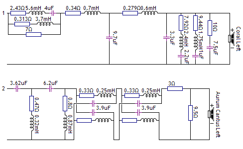

Just for grins, here's the result of one of my own passive crossover labours :)

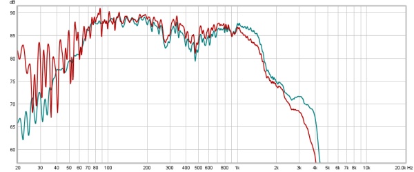

With just an electrical second-order, I am not too far away from an active LR4. The green line is the passive. Note the obvious insertion loss. As you can see the knee of the passive is very sharp indicative of a moderately aggressive Chebyshev alignment. That, coupled with the inherent inductance of the woofer itself, are not that far behind active LR4 in suppressing the cone break-up at 3-4k.
That's why I claimed, passive may not win over LR 24dB/oct, but it will be a good fight, not a round one knock-out.
(These are half-space measurements. Below 100Hz is just background noise. Please ignore that.)

It's actually two cascaded first order all pass filters to get sufficient delay for what I needed.
Vituixcad provides all pass filters (only 1st order unfortunately) as a block you can add based on the roll over frequency and load impedance, so they're very easy to add and adjust. Maybe enter your existing crossover and driver measurements (including at minimum impedance and on axis frequency response, it can also take additional polar measurements) into Vituixcad and give it a try ?
It's the first time I've tried to use a passive all-pass filter in a crossover and it seemed to do the trick nicely, with pretty good phase tracking between 2 and 5Khz. (3Khz crossover frequency)

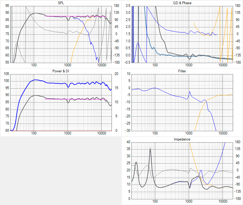

Getting good tracking at 6Khz is not easy because the full range driver itself is non-minimum phase at high frequencies due to the whizzer cone, with an excess group delay bump around 6Khz where the two cones cross over. This complicates things a bit and is one reason I brought the original 4Khz crossover down to 3Khz...

Thanks Simon, I fixed the image in your post (I can't seem to get rid of the click to see full size link though).
The all pass is quite complex! I guess I should have expected it. I've not seen one done passively before. I'll have to check out vituixcad (I think I may have bookmarked it at some point but haven't tried it. I did some new measurements yesterday and found my speakerworkshop sim is out by about 0.8db through a reasonable range comparing the sim to the actual measurement of the crossover, I'm not sure if that is the sim, or some of my components are off (my home made coils quite possibly are not the values I have put into the sim). It would be interesting to see what result I get from another program.
Tony.
It's just a Lattice all-pass filter, of the low-in-phase configuration:
Lattice phase equaliser - Wikipedia
Remember I have two of them cascaded in series to double the delay though, as the driver acoustic centre offsets are quite large on these speakers due to the depth of the full range driver.
You're likely to only need one stage which is 2 coils and two caps.
One nice property of a Lattice configuration is that when the values are correctly chosen for the load impedance (which vituixcad will do for you) and assuming that load impedance is a relatively flat resistance across most of the range where the filter is active, they will present the same impedance at the input, which means they can be cascaded, also that the high pass filter in front of it sees a "normal" load similar to what it would see if the all-pass filter wasn't there.
There is a small amount of interaction but it is minimal, and you can tweak it in the simulator anyway.
Keep in mind that the tweeter negative is now isolated from earth so you can't directly connect a measuring device across the tweeter unless it's ground isolated. (I use audio transformer isolation anyway when I measure the electrical response of a crossover so my measurement system is already floating and ground independent)

As long as you've got some good measurements to work with (you need measurements with true measured phase included) its very quick and easy to use. And I now have one completed design that I'm very happy with that was done entirely with it, and ARTA and LIMP for measurements.
I was quite impressed by how close the measured filter responses were to the simulation, once I fixed a couple of out of tolerance components the lines literally overlaid perfectly...
One thing that helps with this I think is making sure to include the actual series resistance of all inductors. The resistance does make quite a difference to the finished response curve.
I did an initial first pass design where I let it apply the default 0.1 assumed resistance for inductors, once I knew what inductor values I'd need I checked the suppliers parts listings to see what coils were available in those values and what resistance I would get with a given physical size, I was then able to plug in the proposed inductor resistances to see what effect it had on the response and how critical it was.
For example for the 0.87mH shunt coil in the tweeter high pass I found that paying a lot more for a physically much larger coil (twice the size) to get the resistance down to 0.4 ohms instead of 0.8 ohms, basically made no useful difference above about 200Hz... as I'm having to jam a lot of components onto the board, the physical size of each coil had to be considered to see how critical low resistance was vs actually having enough room on the board to fit everything in the space available...
Once all the actual resistances of the inductors are in you can go back and tweak the inductor, capacitor and resistor values slightly to re-shape the response back to where it was before. (Which I did by comparing it to an overlay taken with the initial design)
So if you design the crossover assuming inductor resistances are negligible then substitute actual inductors with much higher resistance, you won't get the result you hoped for. But if you put the actual resistance values back in, tweak the other components to compensate you can actually get the original response you wanted with real inductors with significant resistance.
Same with the all pass filter - the actual coils have 0.33 ohms resistance and the response differs quite a bit from what it should be until the cap and coil values are tweaked to compensate. There will be some attenuation of course but that in turn is then compensated for by using slightly less attenuation in the L-Pad! (Even with the losses in the all pass filter coils I still needed nearly 4dB attenuation on the tweeters from the L-Pads)
In the end you can still get exactly what you want if you're prepared to go back and iteratively tweak the interacting values a bit. When you can see the results on the frequency response, phase etc in real time as you adjust values it's quite painless to do this.
