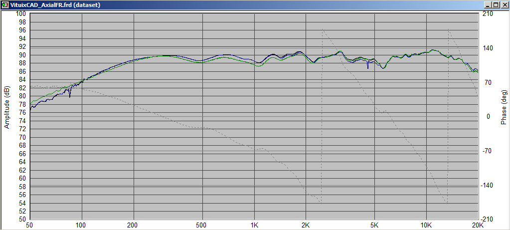

Simon, I was measuring with HolmImpulse with time zero locked, however I did notice that there was some drift I could not account for when I did a second tweeter measurement.
I decided to extract minimum phase and work out my actual offset and use those instead (using Jeff Bagbies method of measuring each driver in turn and then both playing together, extract minimum phase and then use those measurements in sim with both drives playing till the sim curve overlays almost perfectly with the measured curve) as a sanity check.
It turned out I needed -3.5mm on the tweeter. Note that these drivers are very close to time aligned, so I guess the difference was me not being quite symetrical on the tweeter vertical axis (it is an MTM).
Below is the difference I got between my first tweeter measurement and the last sanity check one. around 0.06ms offset. I'm assuming that this was a latency change in the sound card. I found that my midbass measrements seemed to be agreeing with my tweeter measurements from a time perspective, and sims using the measured phase (without offset) and the minimum phase (with offset) were basically the same.
I used to use speaker workshop for measurements (which does do the two channel thing, but found it too unreliable and switched to holm impulse. After reading the vituixcad measurements doc, I might have to give ARTA a try 🙂
Note that one of these measurements was high passed at 200Hz and the other was from 20Hz.
Tony.

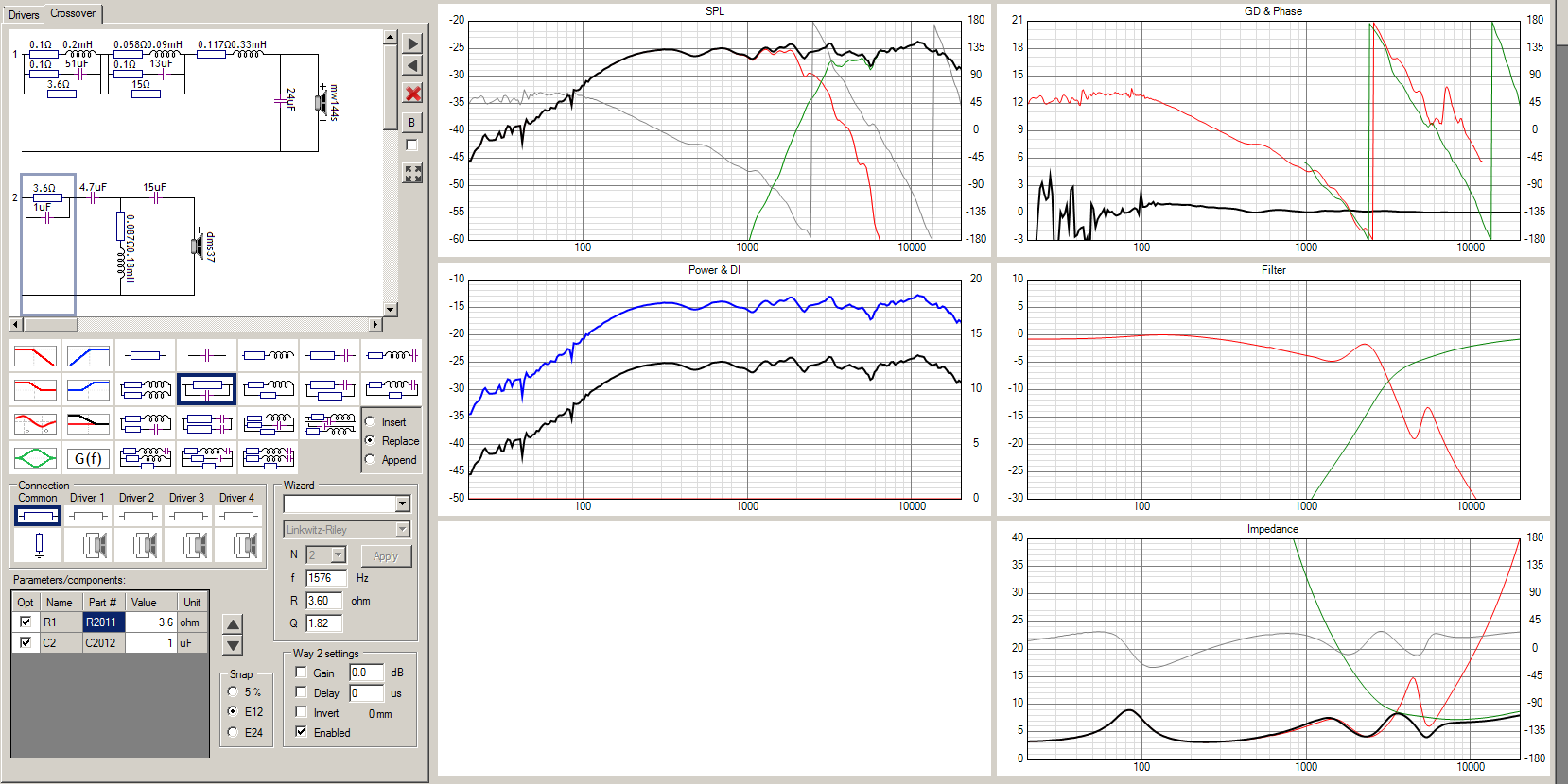

Attached is a comparison between the two sims and actual measurement.
Black is vituixcad
Blue is speaker workshop
Green is actual measurement at 1.8M taken directly after the individual midbass and tweeter measurements.
As can be seen there is something not right in the low pass section. I suspect some out of spec components. Both speaker workshop and vituixcad are out up to about 2Khz (and pretty much agree). vituixcad is very good above that, speaker workshop has a bit of an issue between about 4Khz and 5Khz.
Tony.
