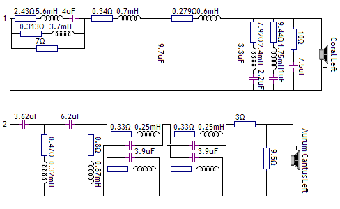

For example consider the 2 way crossover I recently finished:
If you look at the order of the sections for the woofer there is baffle step correction (and a peaking filter) first, low pass filter second, shunt notches and zobel network last.
For the tweeter the high pass filter comes first, then the all pass filter, then the L-Pad. There is a good reason for the order chosen for each section.
Trying to design a network this complicated manually (on paper and physically without simulating) and then tune it to the exact response required by substituting actual components would be very tedious and time consuming to say the least, as every time you adjust one component several around it will need re-adjusting as well.
However with the right simulation software, an accurate measured raw driver impedance and frequency response(s) you can get feedback very quickly in real time as you develop the design.
I did the crossover design above from just an idea in my head to more or less completed in a single weekend using Vituixcad. I did further tinker with the values over the following few weeks while I waited for the opportunity to order the components, (pay day ) but the initial over the weekend design was 95% of the way there and only slight component value changes occurred afterwards.
Furthermore, when I assembled the crossover and tested the filter electrical response with the actual speakers connected as loads, apart from discovering two out of tolerance components and replacing them, the actual measured filter response was so close to the predicted response that I was able to export the predicted filter response from Vituixcad, import it into ARTA as an overlay, overlay it on top of the measurement and the curves overlapped perfectly... (Within a tiny fraction of a dB)
With the two out of tolerance components I saw significant deviations between the two and that's what brought my attention to the component tolerance problems.
With such accurate simulation possible today and a bit of understanding of the limitations and techniques used in passive designs there is no reason why you can't get a really top notch result with a passive crossover.
Sometimes having a speaker be a single passive box with just two terminals on the back that can be driven by any amplifier is very advantageous. The inside of the speaker is more complicated but everything outside it becomes much less complicated!

Just for grins, here's the result of one of my own passive crossover labours
Marco
