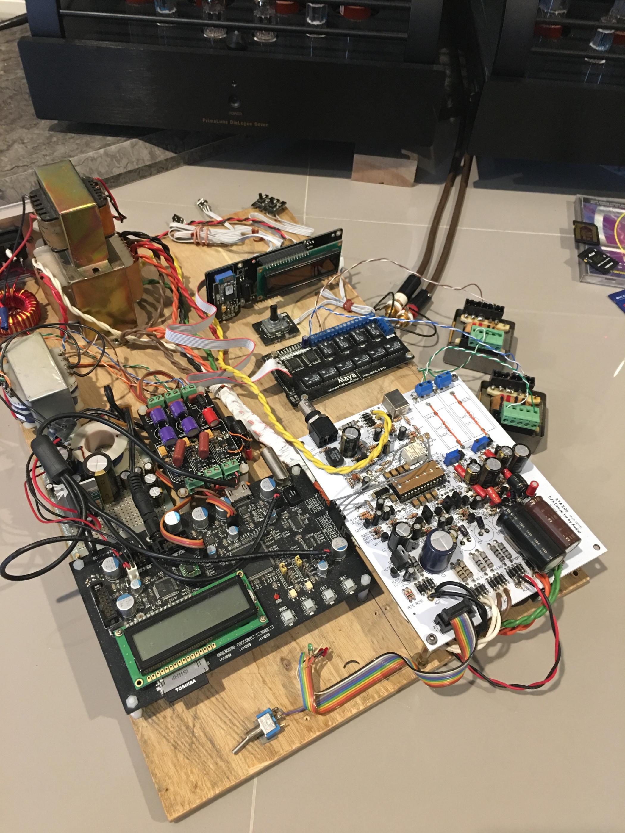

@dddac,
Did you reclock the I2S after the DSP? If so, what was the best way you found?
I am using the Ian Canada FiFoPi to re-clock theI2S before it goes into the DDDAC1794
