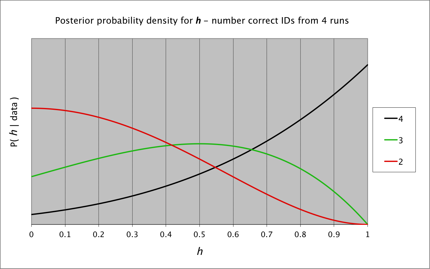

4 consecutive correct identifications on an ABX test is nothing like definitive evidence:
You'll see that I use an illustrative example there based on codecs.
I am a big fan of ABX tests as they are the closest to being scientific that we can be using our ears and perceptual machinery not measuring instruments. What is being measured is the ability to hear a difference which is the crucial first step before we get into the complicated world of preferences, ranking etc. They do take very careful setting up though, and a correct analysis which is not always obvious. I used to do this as part of my role for KEF in the early 90s when Laurie Fincham and Richard Small headed up the R&D dept, and then later as a consultant to a University tonmeister course for research.
The ability to set these up in the digital domain with levels set exactly equal and the double blind/choice capture completely automated is very appealing.

On a first look the analysis of your A/B protocol would be identical to ABX except if (4) is allowed which makes it a censored sample that can be handled but is quite a bit more complex. For those interested, plot of the p(h) for 2, 3, 4 correct out of 4 tests is attached. Worth bearing in mind that the expected number of correct IDs from a monkey or random number generator without any ability to make considered choice would be 2, and this is reflected in the plot.
We did pre-checking and training of subjects and found that we had some listeners who were consistently more/less sensitive than others. In preference tests that we did with European partners they became part of the ANOVA analysis which removed their variation as a covariate. Preference tests are far more uncertain given realistic sample sizes - one reason that I preferred ABX-type tests which established if a difference could be heard.
