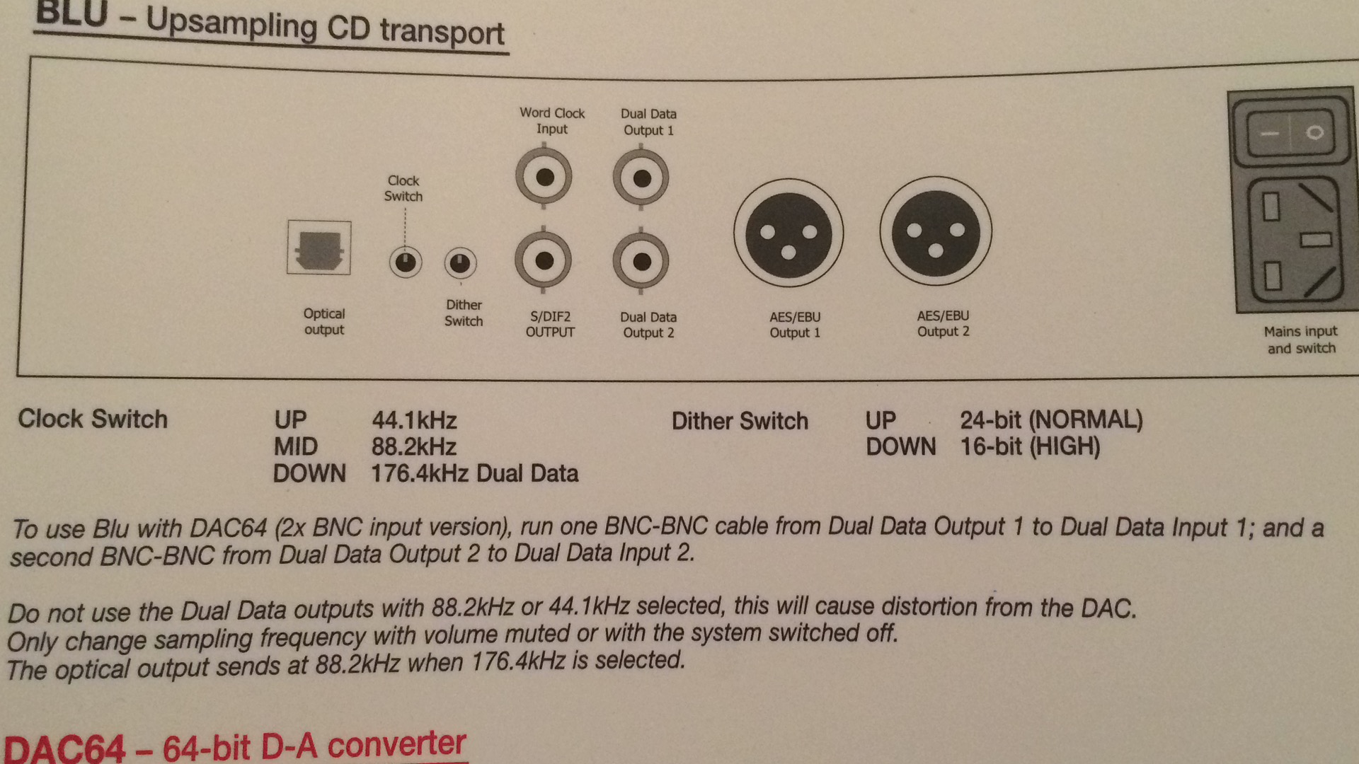

Mine is galvanically isolated from the source. However all dac circuitry is grounded together to minimize jitter through isolators. Mine is also shielded in a roomy steel case for protection from EMI/RFI incursion.
EDIT: @Hans, effect of upsampling depends on the dac. For my dac the effect is very slight. However, conversion from 16/44 PCM to DSD256 is an easily audible improvement.
Sometimes i also use MuMetal to shield the chips but not this time.
The nice thing about a NOS DAC is that you can provide oversampling or not (depending on the source) and hear the difference directly.

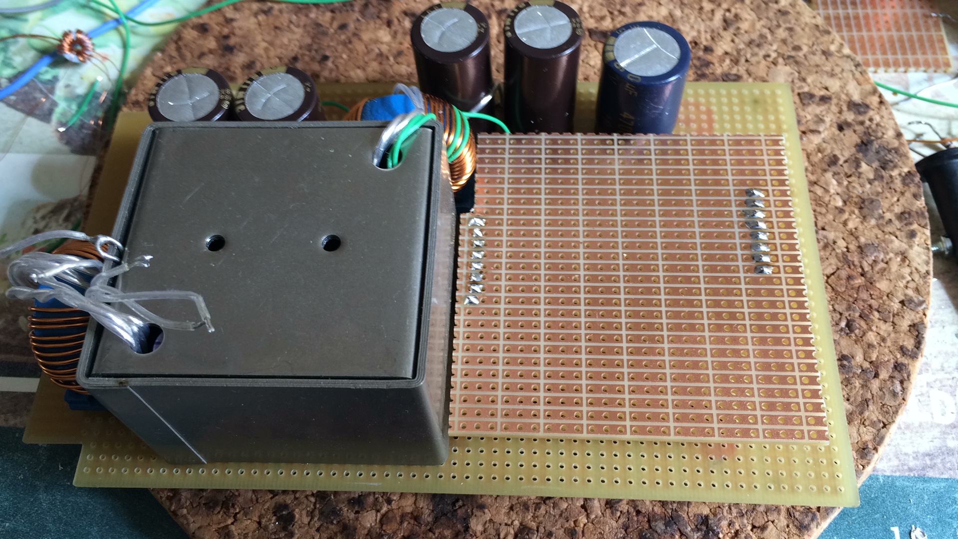

My DAC is dual mono and balanced (the latter is not a requirement), no ground connection between source and dac chips (totally floating, and i mean totally floating) The DAC can be seen as a phono cartidge with 2 individual coils, only when connecting it to a pre amp the 2 grounds will meet...
...The power supply is something else alltogether as i use a generated HV RF sinewave (with very low noise) and transform it to the desired voltages without the use of any regulators (no need as the sinewave is super stable and can deliver enough power). As the noise of the HV sine wave will be transformed to a low voltage so will the already low noise on the wave, leaving almost no noise at all (this is the advantage of all transformers when transforming high voltages to low voltage but not the other way around, maybe nothing new here). The other advantage is that by using RF the transformer cores are small and unable to pass any 50 or 60Hz noise other then modulated on the RF sinewave.
I had no idea that you would provide such an interesting response, Lampie. Any chance of showing us a schematic, especially of your unusual power supply implementation?

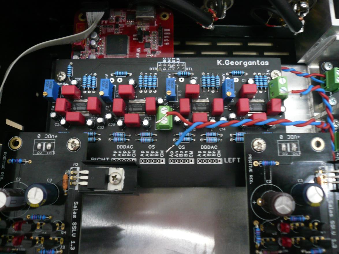

Mine is taking the opposite route from Lampie519 regarding grounding. All grounds only meet at the galvanic isolated I2S source and then to balanced floating preamp and monoblock power amps. Currently I'm rebuilding it in a way that it will be able to play both NOS and OS from the same chips working at the same operating conditions. The plan is to install a front panel switch to select mode "on the fly". Then there will be a lengthy as necessary listening comparison before I move further to this adventure: NOS, Oversampling... and now Hybrid(?)

I do not want to share this part as it is something i would like to commercialize. This has not yet been done before by anyone (as far as i know) to this extreem.
The result is.... no "sound" at all.... it is just music free from any digital artifacs (more analog then analog).
I have taken these DAC's to a friend who imports turn tables (Nottingham etc.) and he called them "magic boxes" .
Do you synchronize your sine wave to a multiple of the sample rate to prevent whistles or is that not needed?
That is interesting but would require a coupling of some kind between the clock and the resonator/oscillator plus it needs to be temperature stable, which is not the case here as it is now free running. In case the frequency would be depending on the clock signal i need also to make sure the clock never changes (fine in my case but not universal). Adding a clock with the same frequency is troublesom and will interfere or must be made "master".
