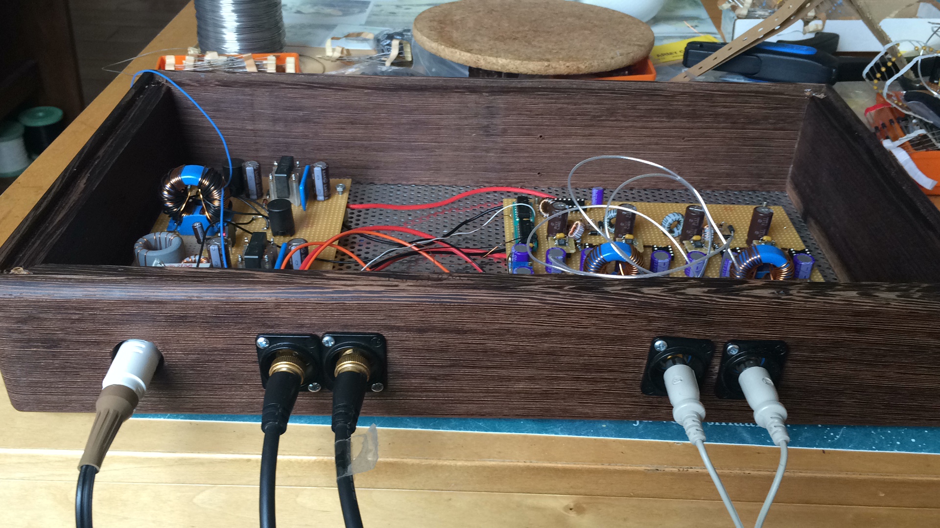

A Nos DAC by nature does not over- or up- sample so it needs to be able to handle the signal offered as pure as possible to be able to outperform any other. This includes the power supplies and ground handling. Here is a lot to gain against all other.
My DAC is dual mono and balanced (the latter is not a requirement), no ground connection between source and dac chips (totally floating, and i mean totally floating) The DAC can be seen as a phono cartidge with 2 individual coils, only when connecting it to a pre amp the 2 grounds will meet.
No reclocking is required but i2s needs to be time correct (between the 3 signals the clock as reference). This is most important to pevent any glitches especially if 176.4khz (or higher) signals are expected.
My transport can deliver at this moment 2x 176.4Khz (dual mono SPDIF) so here is my limit. I hope to test the new Hugo M Scaler soon.

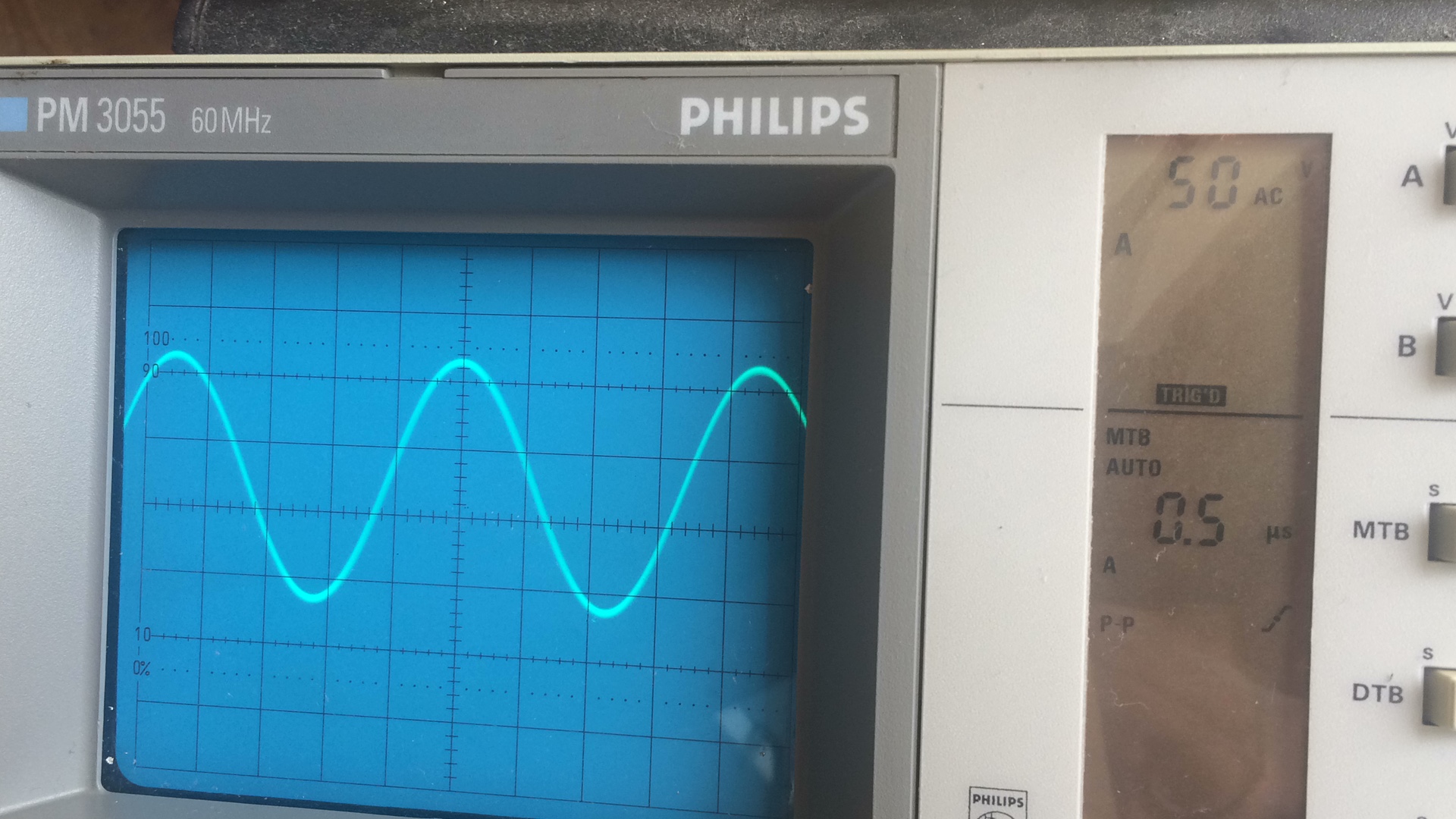

The power supply is something else alltogether as i use a generated HV RF sinewave (with very low noise) and transform it to the desired voltages without the use of any regulators (no need as the sinewave is super stable and can deliver enough power)
As the noise of the HV sine wave will be transformed to a low voltage so will the already low noise on the wave, leaving almost no noise at all (this is the advantage of all transformers when transforming high voltages to low voltage but not the other way around, maybe nothing new here). The other advantage is that by using RF the transformer cores are small and unable to pass any 50 or 60Hz noise other then modulated on the RF sinewave.
