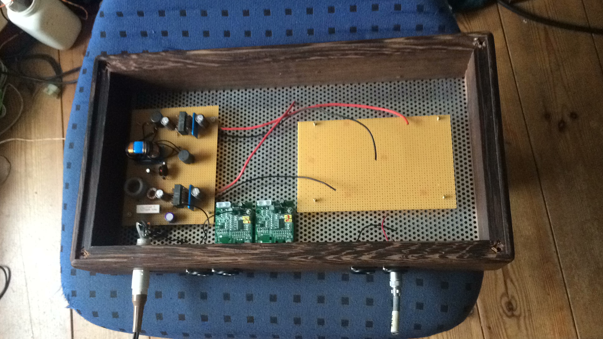

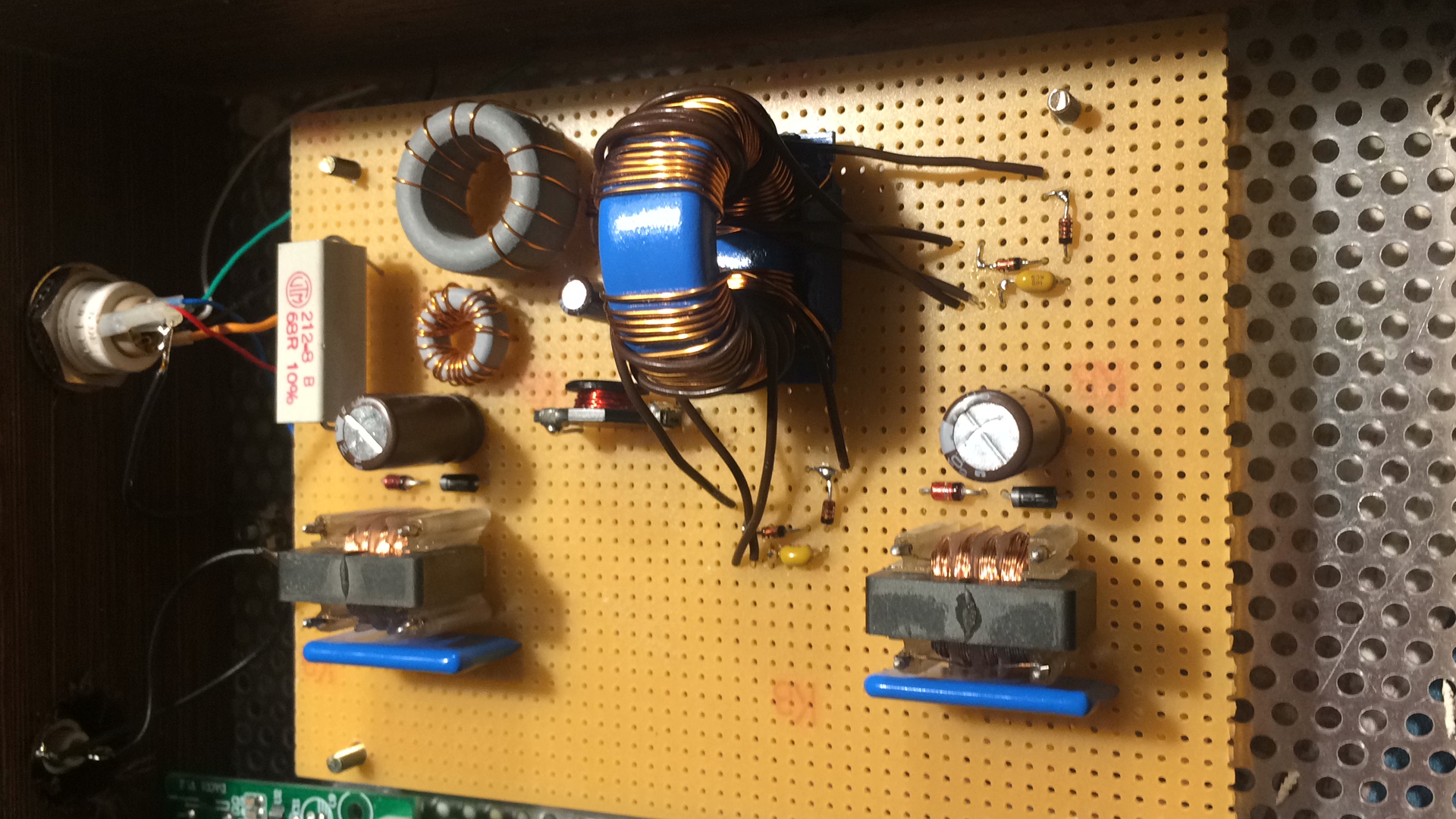

The filter i use is not DIY (at this moment as i do not have the skills yet to create one myself in this quality). So i purchased one (Chord).
I use different NOS 16bit Dac's as i have 2 systems. One is balanced dual mono (2 mono SPDIF inputs) capable of handling 352,8kHz max sampling rates.
So i can use a filter that can upsample to this sampling rate. No additional bits as this i feel does not make any difference (correct me if i am wrong).
I think i have explained the dac's in detail somewhere. They are "floating" meaning no ground connection anywhere (like a phono cartridge).
This will improve the blacker then black quietness... and microdetail/microdynamics
Another consideration is processor activity during the DA conversion, real time oversampling process in the DAC/filter chip, in some cases
maybe even source computer, could be a source of interference.
If it exists it could be avoided with pre-oversampled versions of the files.
Why? for the sake of this discussion.
It is not practical or something I would bother with in normal use, but it could be a consideration here.

I try to finance my hobby this way, so yes... maybe offering something as a kit could be an option. However it is kind of "fiddly" as it requires a lot of tuning (resonant circuits are involved). Until i have not yet figured out how to create a fool proof easy to copy design i will not offer any. I will get too many questions if it fails. Now on the other hand if i publish it then there could be some clever guys (as i am actually not very clever at all just pretending) out there who will solve this and run away with my idea, I hope you understand now a bit why i am hesitating. Also as i think i am on the right track i do not like to discuss my findings in any way. As stated earlier, you need to have at least heard it to be able to join a discussion in the first place.
