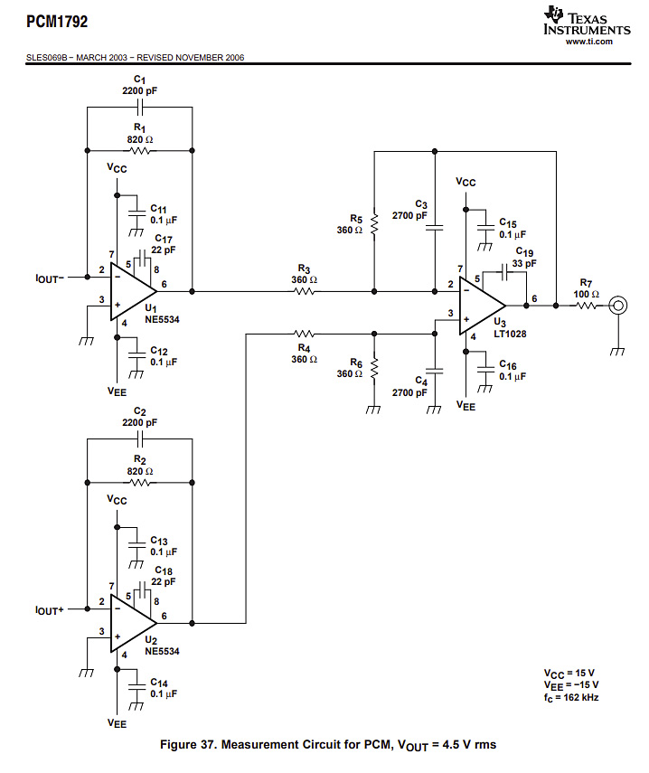

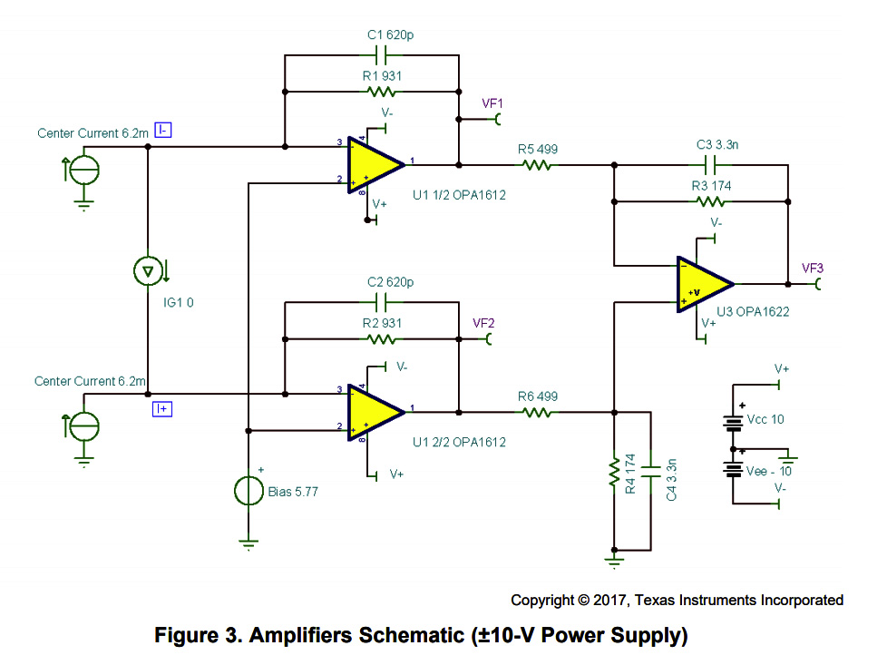

Hi Ken,
May I comment that your links concern R-2R voltage output Dacs.
I thought it may be interesting to add to this that TI has changed it's own view on I/V conversion for the 1792/1794 current output Dacs, see page 3 to 6.
https://www.ti.com/lit/an/sboa237/s...953343&ref_url=https%3A%2F%2Fwww.google.nl%2F
In the images below their suggestion for the I/V with a 5534 from 2003, but 14 years later in 2017 they came with a new circuit diagram.
A much faster OPA1612 with a much smaller cap.
That seems quite a lot better.
Hans

Hi Ken,
Hans
