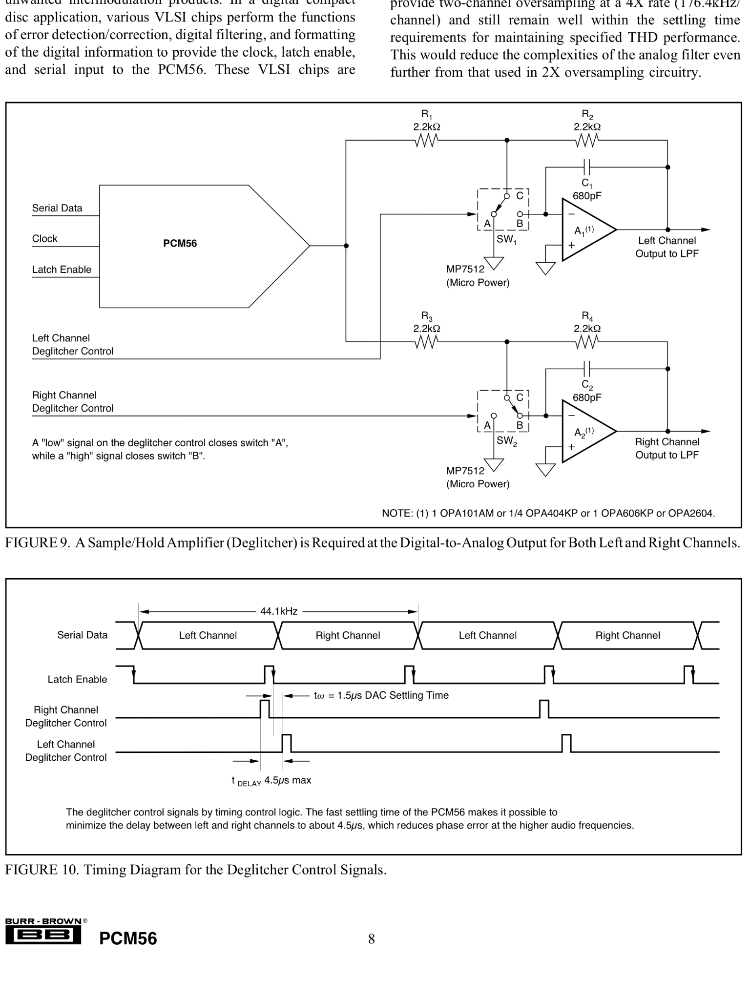

I have some NatSemi LF398H S/H circuits, could they be used as de-glitcher after a DAC? The output transient does not look very nice:
http://mdc.custhelp.com/euf/assets/images/KB_856_NatSemi_SampleHold_circuit.pdf
Or maybe even a 74HC4066 analog switch could do (as Frans Sessing recommended)?
Also, have a look at the interesting approach to a post audio DAC sample-and-hold circuit that is shown in the attached Burr-Brown PCM56 data sheet photo.
