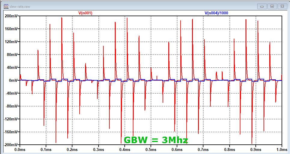

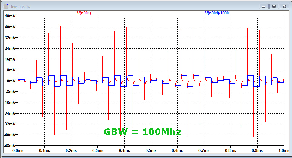

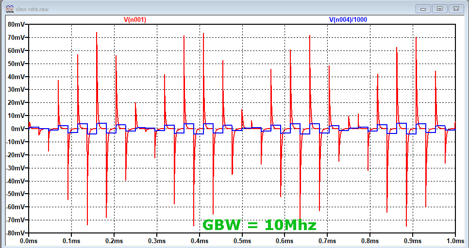

That's a good point, but it also depends on the GBW.
Images below are made with a 10V/usec op-amp, where the GBW was varied between 3Mhz and 100Mhz.
Red line is the voltage at the amp's input, and blue the 20Khz 2.8Vrms output/1000 in all three cases with a 10R resistor placed between output and 2nF cap.
The 100Mhz version shows +/-40mV at the input, whereas the 3Mhz version will be overloaded with +/-200mV peaks.
So a careful conclusion might be to use a op-amp with the following specs:
Rout open loop < 10R
Slew Rate > 10V/usec
GBW > 100Mhz.
This means that this I/V converter should not be taken too light-hearted, which convinces me more and more why a simple RC network followed by a buffer may produce a superior sound.
A S&H may have advantages, but with D/A's fast enough and S&H circuits not being without flaws, I think the "simple" RC network is a potential winner.
To complicate things further, the "linear" range of the input stage is proportional to the ratio of the slew rate to the gain-bandwidth product, so your 100 MHz, 10 V/us amplifier will slew at a much smaller error signal than a 3 MHz, 10 V/us one.
