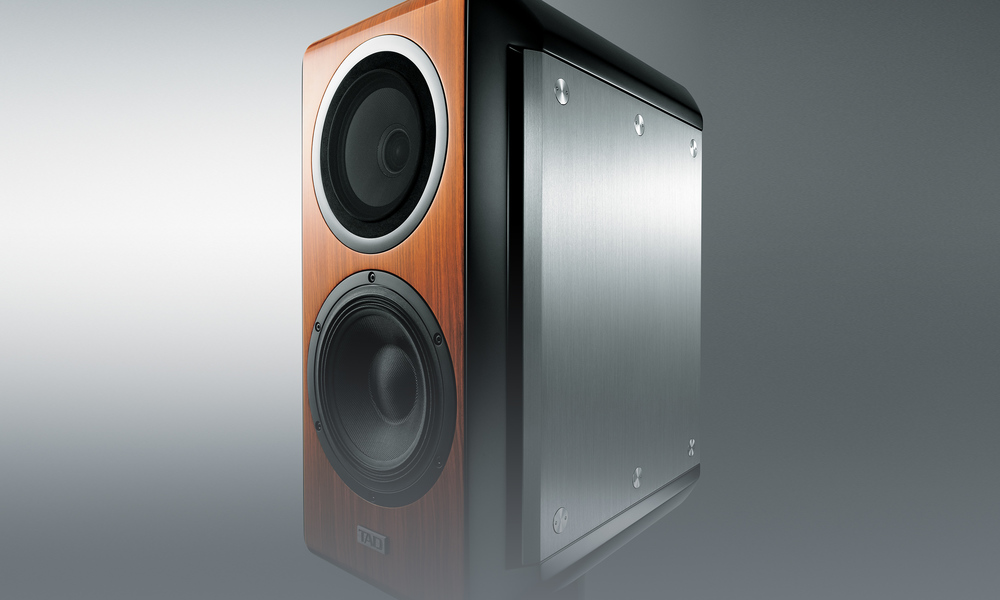

I previously used B&O vs Magico as an example. But it is very difficult to find proof for the Benefit of Mr. Roundover...

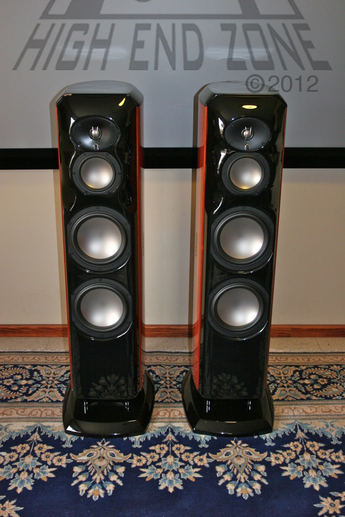

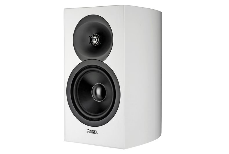

I'm cynical about this, but I personally believe that Kef and Revel are "saving" roundovers for their best speakers because roundovers make an audible difference.
Similar to how I can't get the best engine in my car unless I buy a package that comes with a bunch of crap I don't want.
$1200 Kef LS50
$300 KEF Q150
$16000 Revel speakers
$600 Revel speakers
I've heard the Revels back-to-back, and the expensive ones image way better. I'm sure the crossover plays a part, but I imagine that most of the difference is the roundover on the cabinet.
