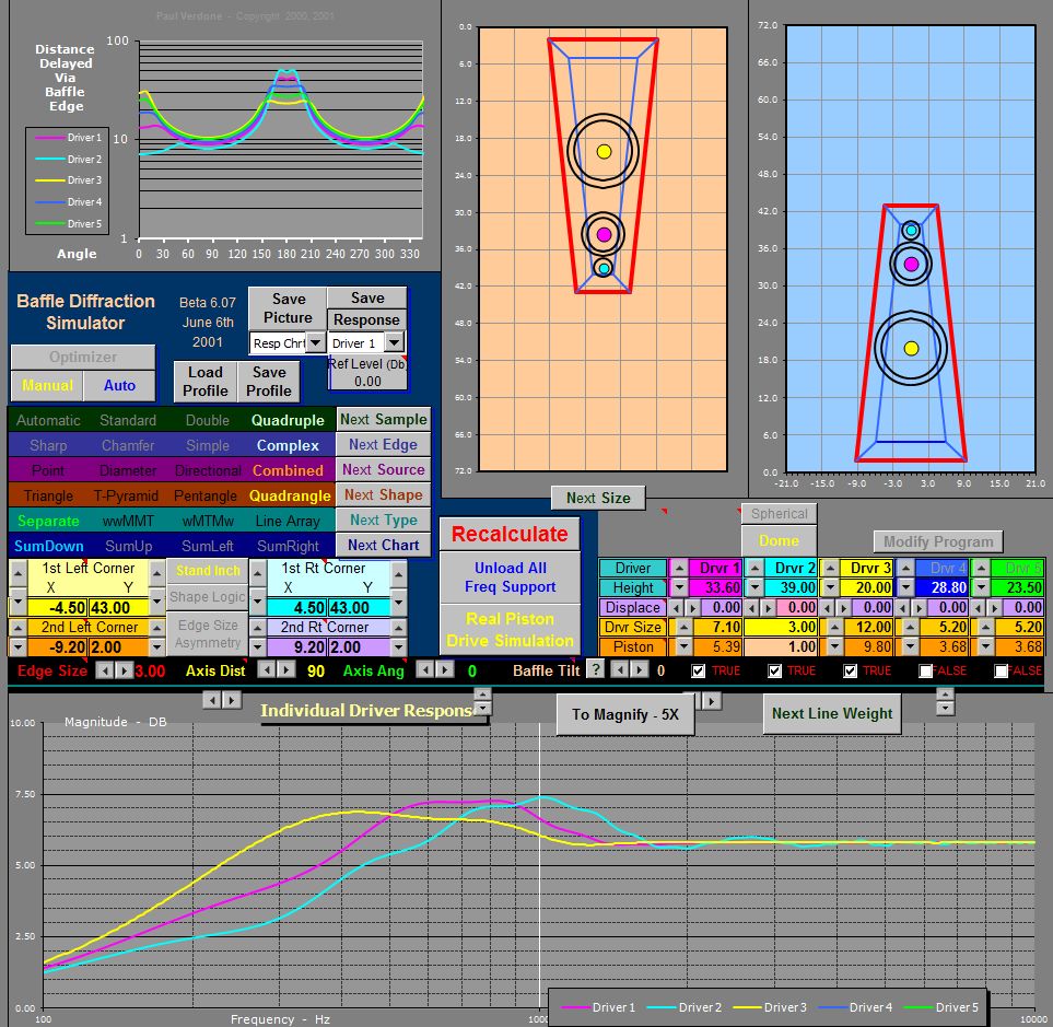

A simple baffle diffraction simulation of "almost cylindrical" round overs for a T-M-W 3-way baffle illustrates low tweeter diffraction effects through the crossover, which should produce a consistent soundstage through the TM crossover. Below the tweeter crossover, both the M and W generate similar 1.8db slow baffle humps, which correctly linearly drop with the baffle W*H dimentional effects. Textbook crossovers perform well with "almost cylindrical" baffles.
---Big round overs = Small diffraction effects = Smooth and Uniform soundstage =??= NEUTRAL?

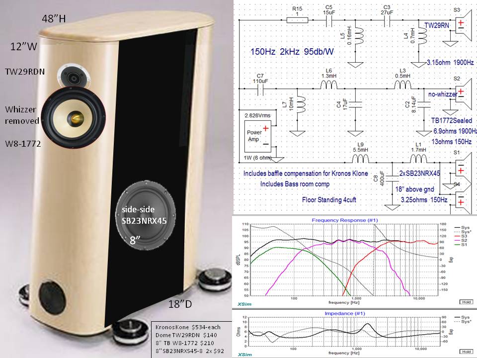

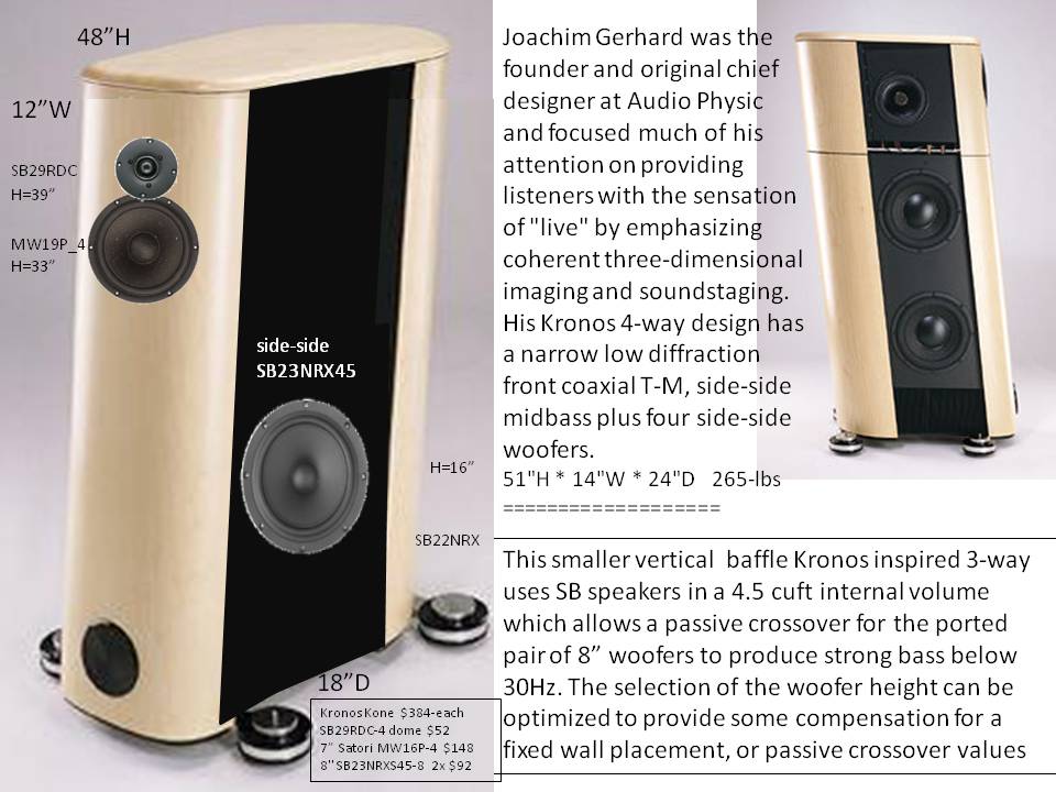

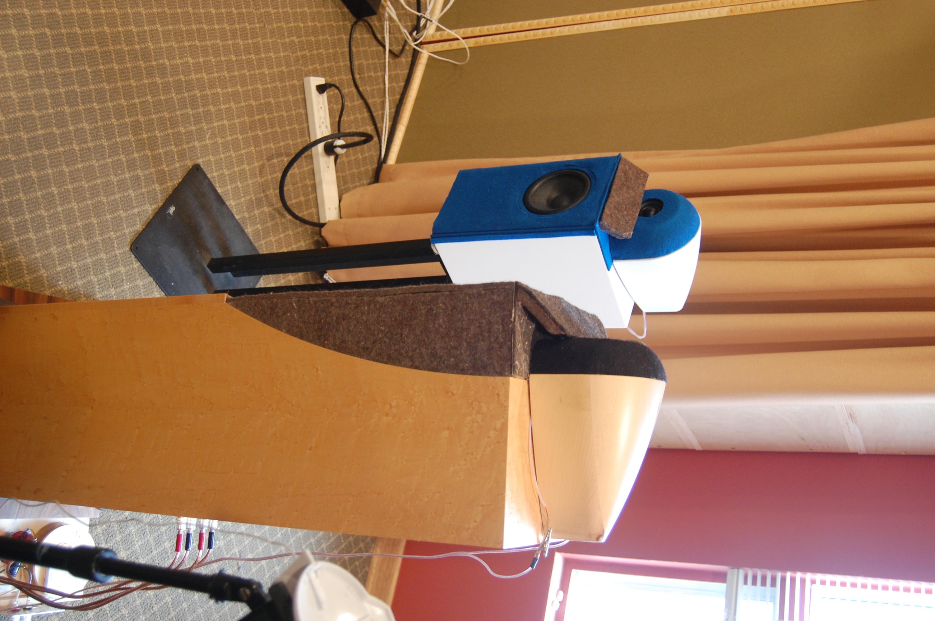

I designed tweeter holders and have plans for a 3way with a rounded baffle for midrange driver. I do think a minimum flat portion is necessary before roundover begins and would like to study this more.

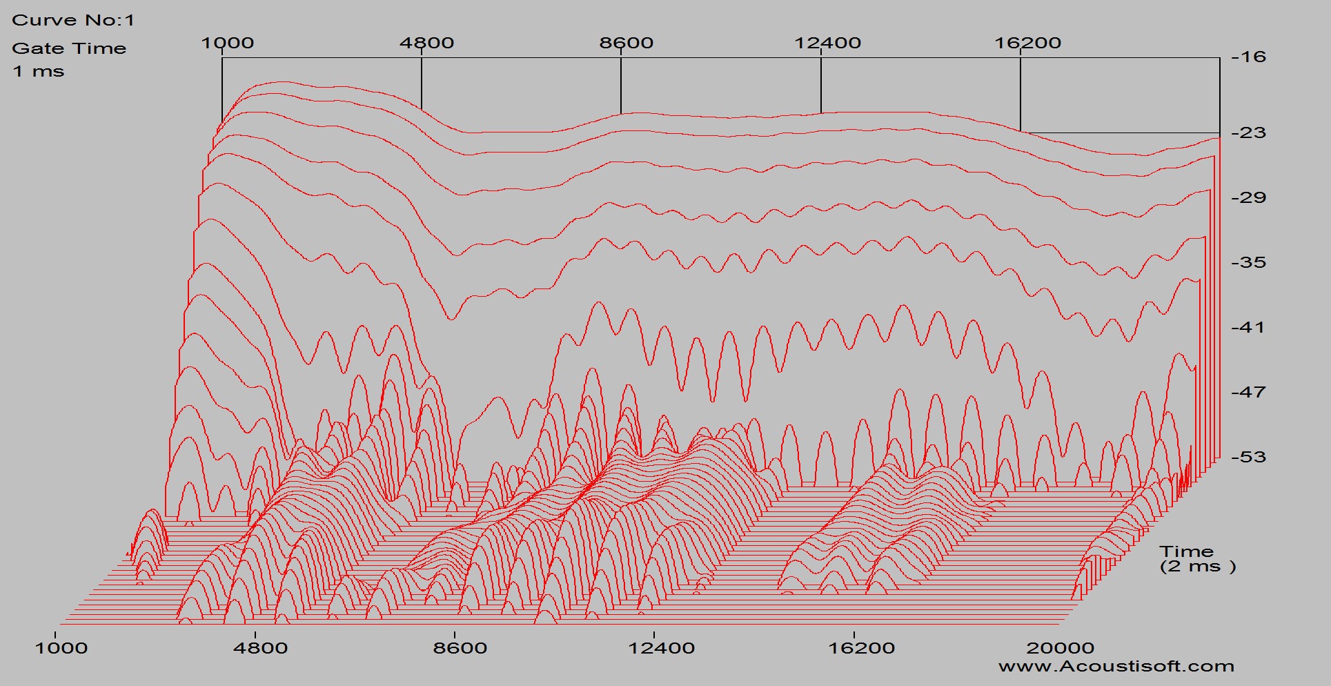

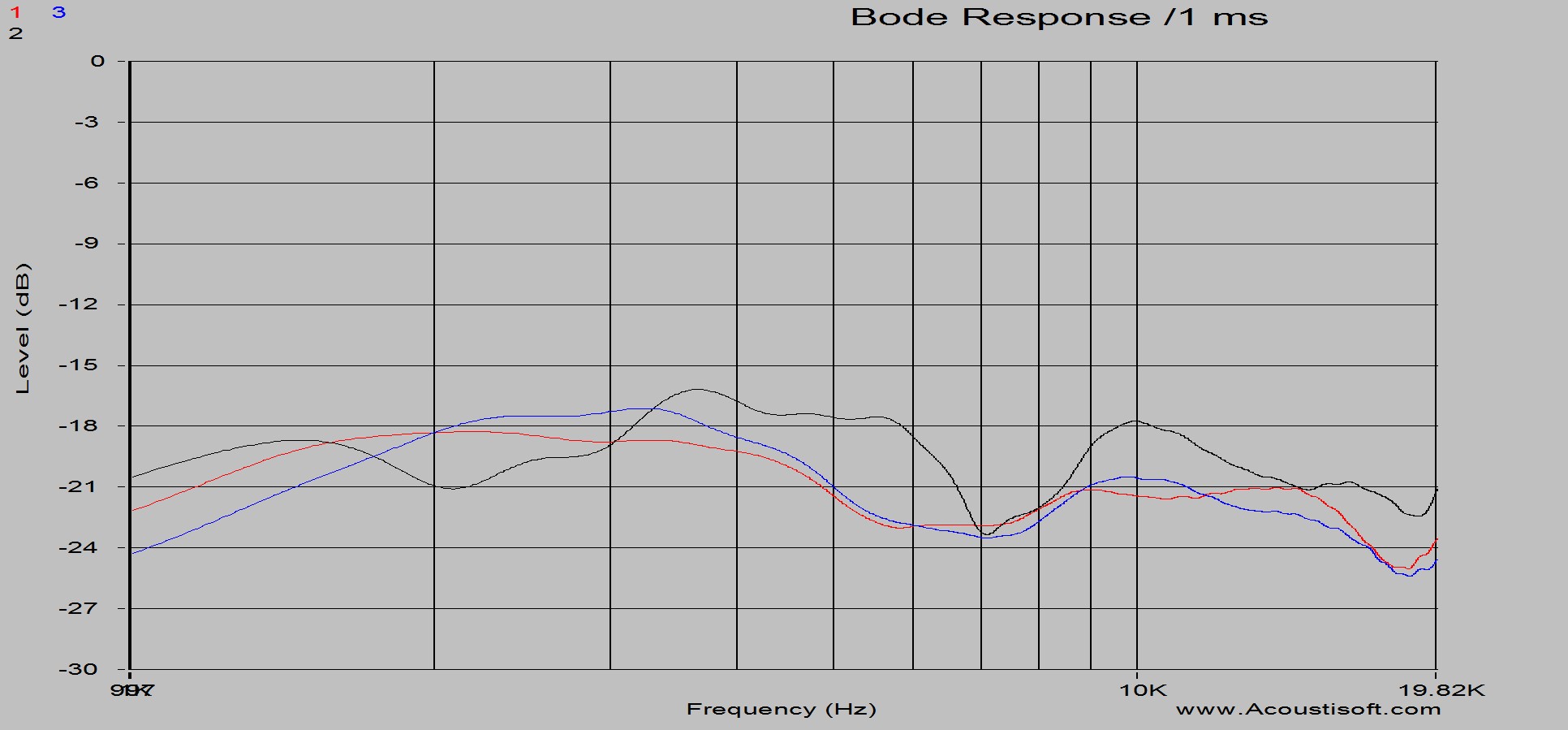

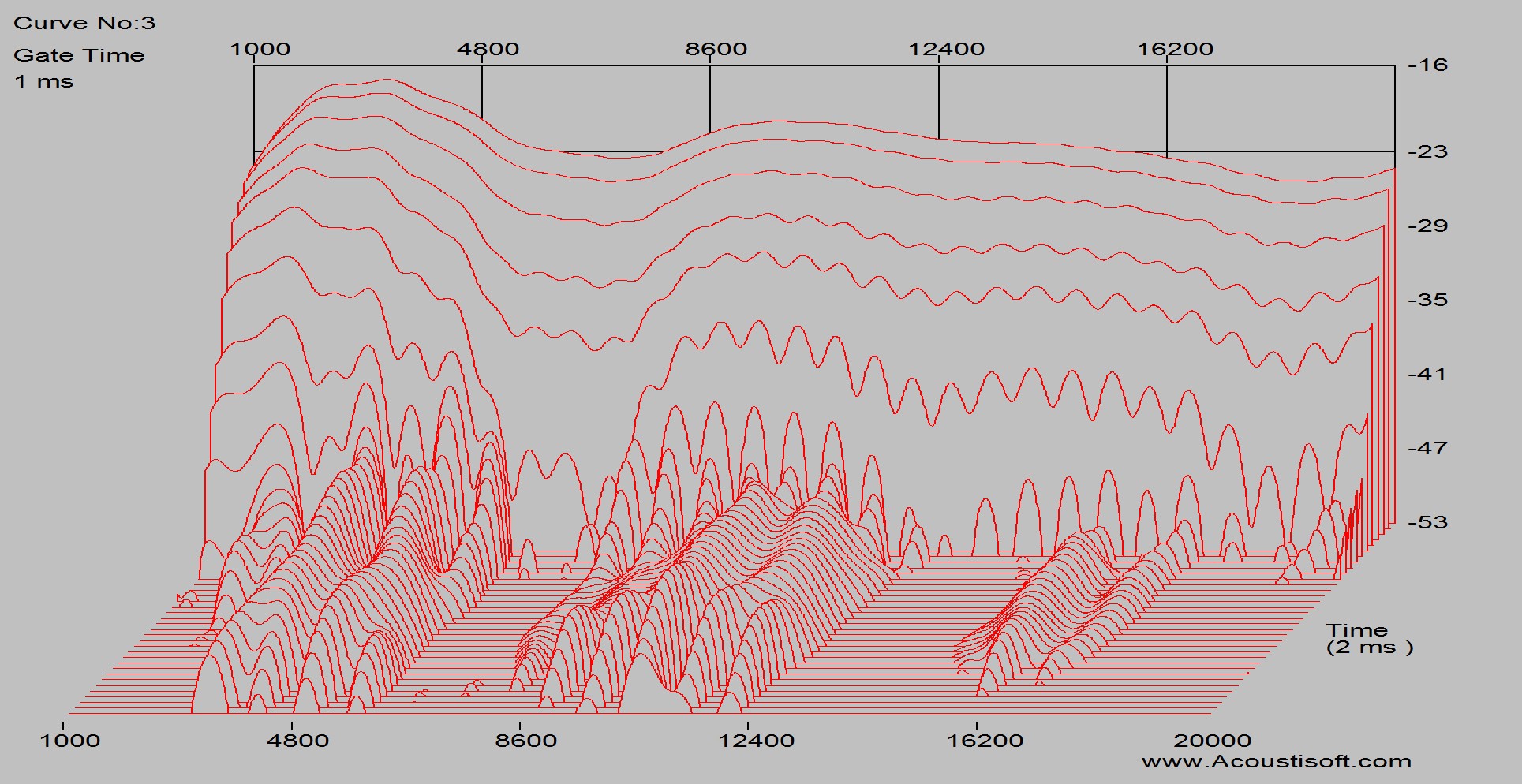

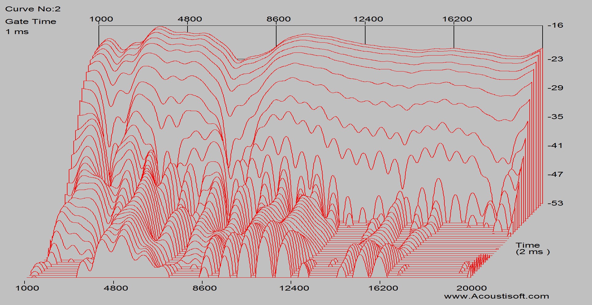

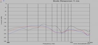

Maybe nothing new, but here is 3 measurements with the same tweeter at 0.2M with 1msec of reflections. Red=rounded holder and felt - Blue=Free air(normal tweeter faceplate only) Black= Tweeter at top center of 10"X16" flat baffle.
FR at the back wall(t=0)of the waterfall plot is the same curve as Bode.
Seems like we need to look at >1msec.
