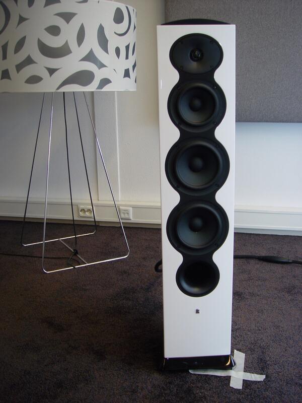

From the first picture...
What does it mean, what happens to the wavefront when two woofers are slightly separated as in the example of B&W speakers, and is it really bad?
Woofer-woofer gap disrupts wavefront launch
