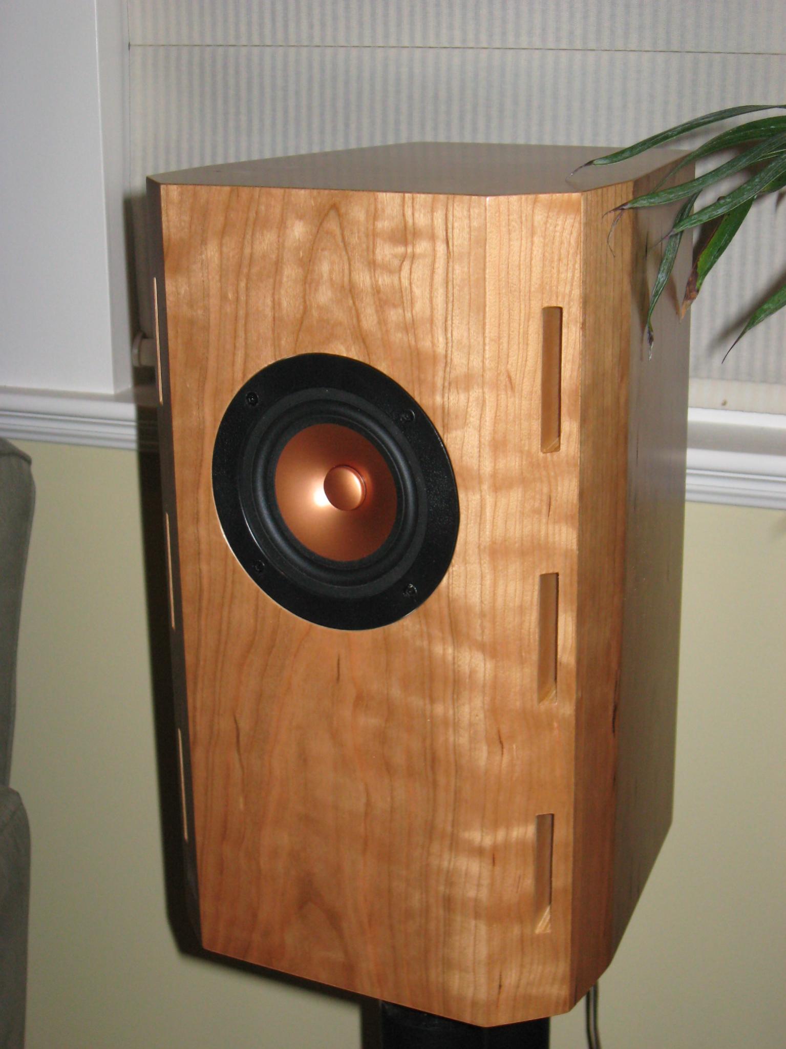

Roundovers definitely help- I use 4" roundovers on my mid/bass cabinets. Acoustic absorption (felt baffles or foam) is another great tool. Bevels are often easier to implement at large scale and are nearly as effective. Baffles small relative to transducer size also help. (Good) Horns and waveguides likewise. All methods above can be effective, and I agree with the subjective comments- the speaker location disappears when you manage diffraction effectively, expanding the soundstage. FR deviations are usually small (1-2dB) when measured, but eliminating/drastically reducing diffraction leads to a much more consistent soundfield at that level of resolution, and once you're sensitive to it (before/after absorption tests are an easy way to hear the influence) it's something that is hard to ignore. Given that it's easy to implement, a pet peeve is designs that leave hard box edges at relevant distances from drivers.

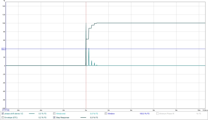

My speakers do a marvellous disappearing act, however when I played with a phase shuffler, the V2 version in post 13 in this thread: http://www.diyaudio.com/forums/multi-way/277519-fixing-stereo-phantom-center.html I noticed the sound panned to left and right was "stuck" to speaker positions.
The shuffler looks like a row of very early reflections in the IR:
I'd like to see the difference diffraction makes, as measured in an IR.
Later tests in that same thread I linked only included phase changes. That didn't have the same effect as the row of (very) early and diminishing peaks of the first versions. No more sound stuck at left and right speaker positions.

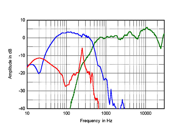

In general a flat and round baffle is the worst scenario! It has same distance to the edge in every directions, so it maximizes diffraction at nominal frequency.
If the baffle is round, it also gives no baffle reinforcement in the low end, which is often a wanted phenomenom and sort of built-in in some driver's response.
Edge roundover is a good thing always, but it has a rather small effect.
Magico S5 has flat baffle but generous roudovers. All drivers are set in the midline, but diffractions are minimal! Much better than B&W 802!
Floor Loudspeaker Reviews | Stereophile.com Notice different scale in off-axis!

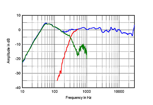

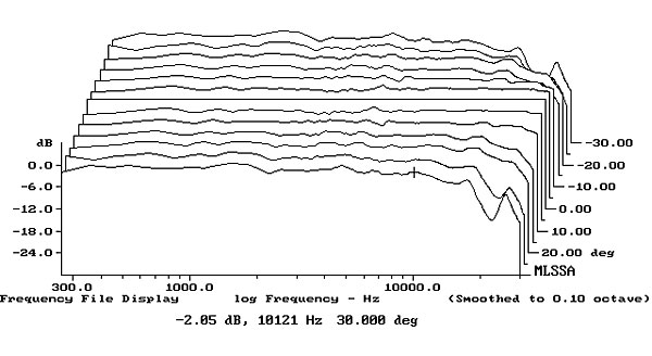

I don't think we are looking at diffraction effects in this example. This seems more like differences in crossover topology to me. The on axis response is normalized while diffraction would even show up on axis. I don't believe diffraction leads to gross off axis errors. It will create ripple in the FR though. The difference in scale (like you mentioned) makes it even worse to compare.
To me, there's nothing to see in these graphs how a B&W performs in relation to diffraction effects. 😕
That would be correct. They are probably using 1/3 oct. smoothing, so any diffraction is simply not seen here.To me, there's nothing to see in these graphs how a B&W performs in relation to diffraction effects. 😕
The improved polar is related to other design criteria.
^Sorry I jus choose normalized polars for comparison, we shoul dlook at the small variation only to see diffractions but let us look other measurements too. Those polars definitely aren't 1/3 smoothed, more like 1/12.
These are on-axis at 50" (125cm) distance at tweeter axis for tweeter, nearfield for mid and bass. Other problem because of nearfield not showing baffle effects.
The clou of this thread is spherical baffle and generous roundovers, which B&W's tweeter and mid do fullfill. The point is that obviously this design/shape is not an easy way to smoothness... Guess which is B&W and which Magico!
