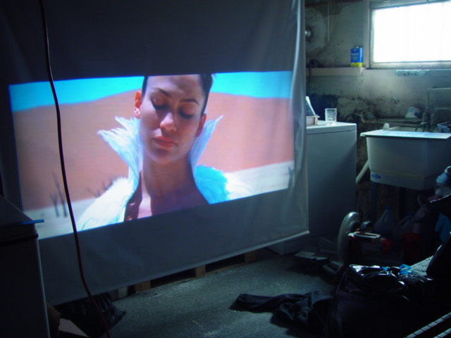

now heres a pic of a 250w projector with a 15" single lcd displayed on a windowshade in my basement with the sun flaring in the window and i must say its completely watchable, now would it be safe to say this puppy is pumping out around 500lm? i would say so
but my point is just because you couldnt get 500lm out of a 250w dosent mean someone else couldnt and you cannot go around telling ppl things like that like its a fact
