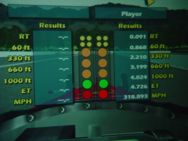

oh yeah 1 more pic i just love posting pictures i know they mean nothing but its fun either way,its hard to drive a drag car being 20 feet away from the stering wheel lol j/k happy DIY people

The direction of the thread changed and everyone involved followed along. The pics Cruser posted were well within the scope of the direction the discussion took, which, despite your preaching about thread jacking, you seem to also be ranting on the same off topic subject. So save the high and mighty tone.
