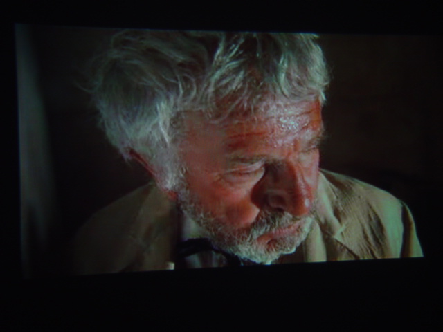

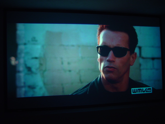

just thaught i would put a few pics up for ppl to look at ,believe me the pictures do it no justice you have to see it with your own eyes
i have never built a projector with less than xga res because once i seen how pixelated 1024X768 was there was no point to go any lower and the box size is a non isue
are you gonna sit there and stare at the projector or the screen?
the only thing i disliked about the comercial pj's i saw at comp usa "becides the bulb price" was the screen door it could be as bright as the sun for all i care if i see the screen door its sad!!!bottom line and oh yeah i saw it bigtime
and if i have to sit 15 feet away so i dont see it ITS PROJECT FAILED!!! mathis once you see a corectly set up diy projector with your own eyes i guaranty your story changes you wont even be able to say low res again
one more thing you can get 15"lcd's for $200..so where can i get a new 3 lcd projector for $400? or $500 or even $800 cmon dude
