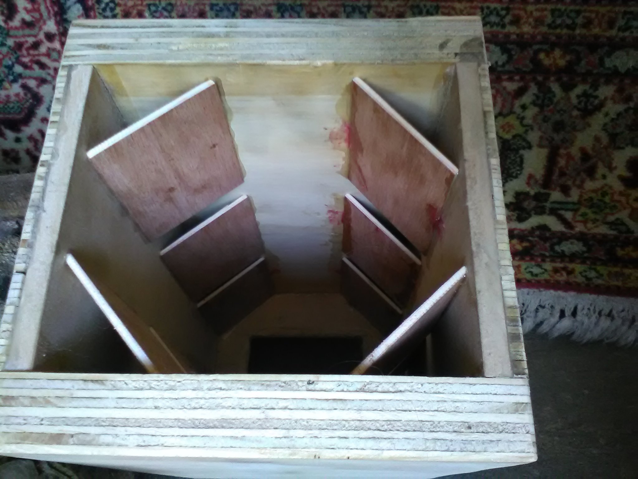

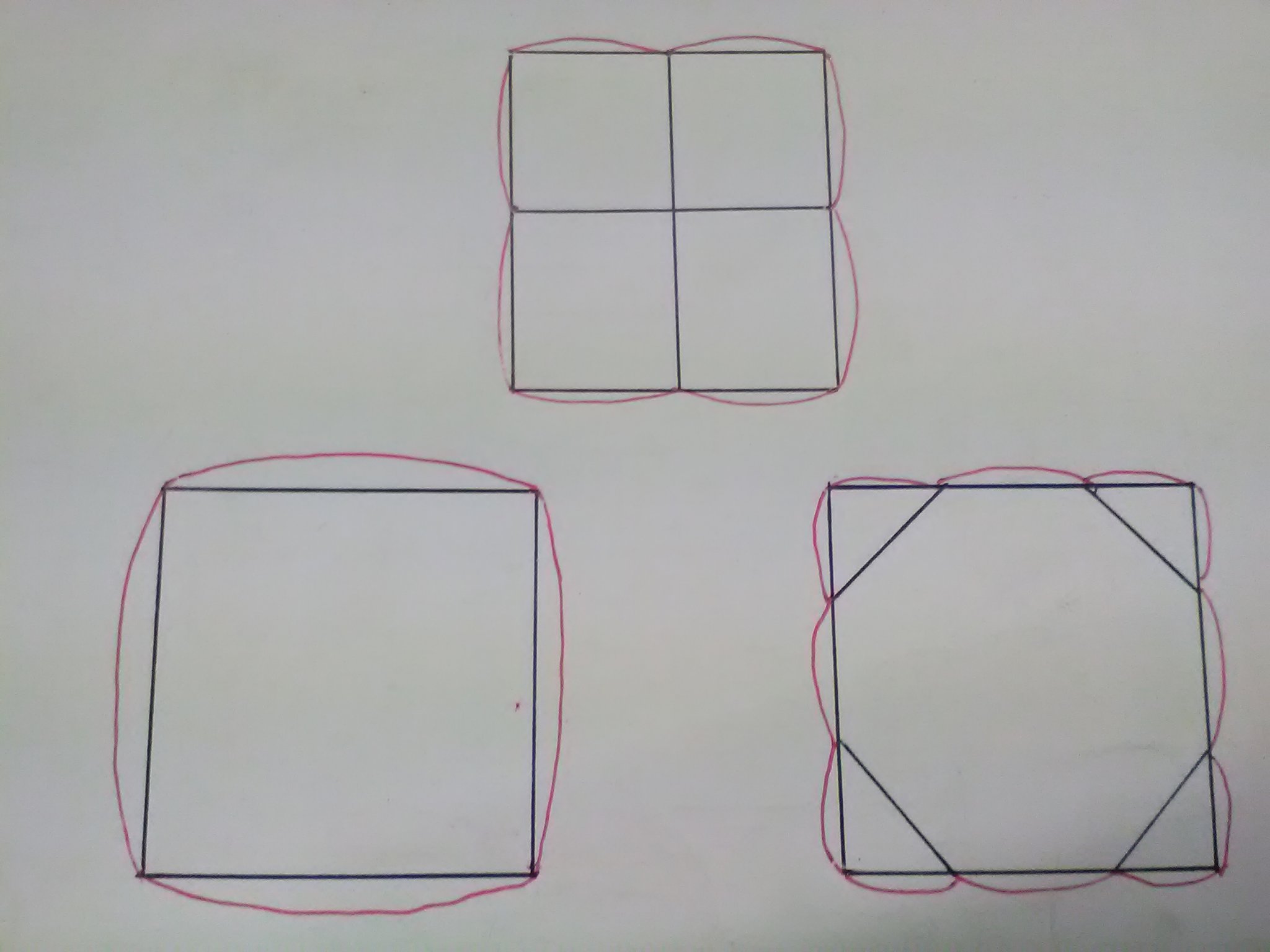

what makes you think your speakers are not braced enough as to make their cab resonance audible?
why I chose 45 deg corner braces instead of conventional cross bracing
You have used the same amount of material to divide the panels being braced into 3 instead of 2. That is good.
Also each panal is braces aginst the 2 nearest panels, as opposed to the opposite panel.
On the downside, the forces are at an angle to the brace, but with typical box construction that is likely moot.
