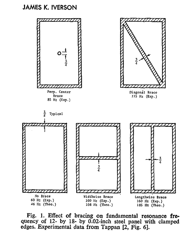

Better just off the midpoint.If its just single brace, put it mid of panel
http://p10hifi.net/tlinespeakers/forum/panel-resonance.gif
And the subpanels the brace creates should have a higher aspect ratio that the panel being braced, and the 2 subpanels should not be equal.

its going to be two braces not just one

Same rules apply, this is just the simpliest form of expressing these suggestions.its going to be two braces not just one

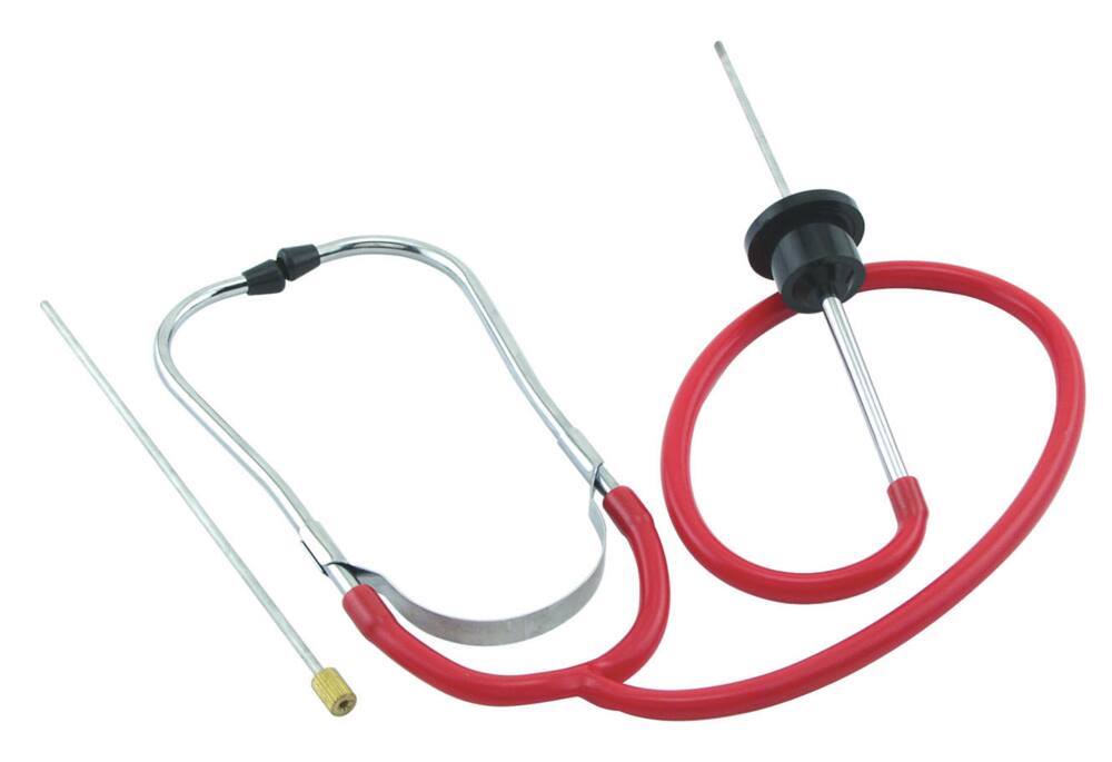

One of the reasons the stethoscope is so good, it isolates the sound of the box from the sound of the room/speaker.It is very difficult to measure how much unwanted sound is radiated by a cabinet in use because it is swamped by the loud wanted sound from the drivers.
Cheap, effective, it just won’t give you quantitiative results.

yeah I was planning to put one brace just below the first woofer and the second brace in the middle of the second woofer.

For that box not the right orientation, you ar ebreaking the rule.yeah I was planning to put one brace just below the first woofer and the second brace in the middle of the second woofer.
But given you are going to be working thru the woofer hole your options are limited pretty much to “sticks”. which are the leats effective measure/
If i was doing this box from scratch there would be a vertical brace from top-to-bottom, just off centre, and bracing the woofers to the back of the box. And some braces side-to-side but not right behind the woofers.
