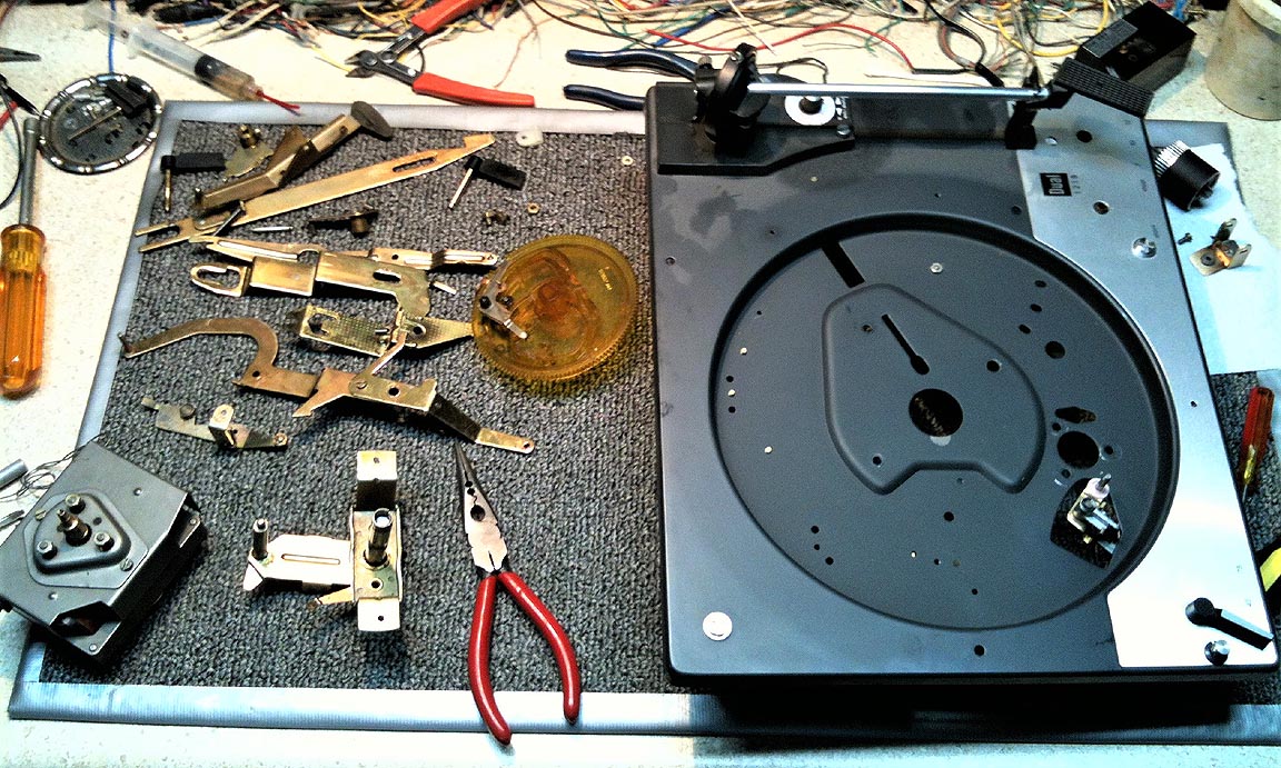

ON THE BENCH NOW...........
Dual 1218 German changer.... needs a full-on overhaul.
One channel was distorted. Tube swap didn't help. Ok. Open it up. 3 happy tubes, one that doesn't bias up. Open cathode resistor! At least it didn't short 🙂 Back up and running and sounding great as usual. Now to figure out why that resistor blew in the first place... Hopefully it was just a tempermental tube 🙂 It's in the bin now.
