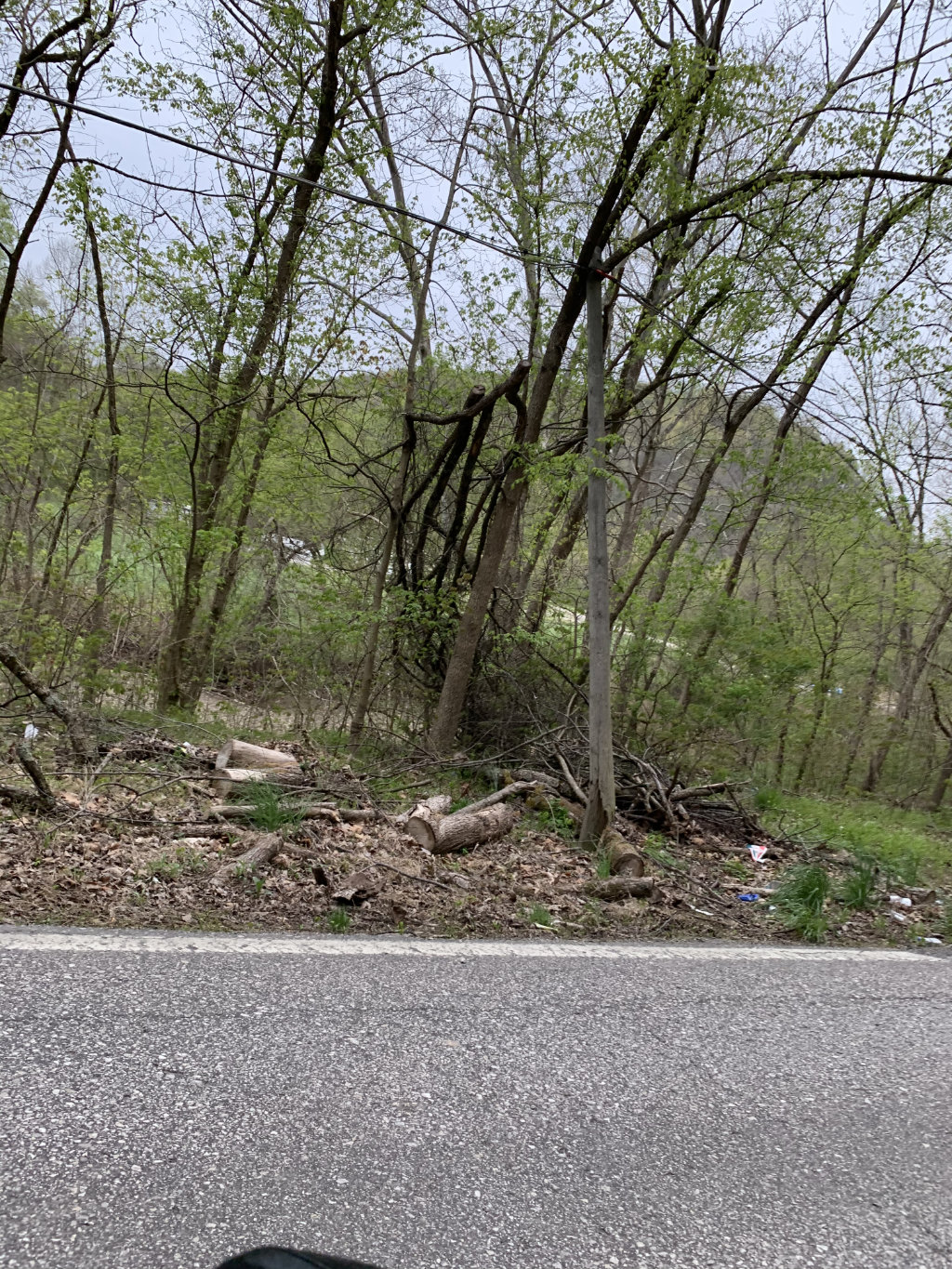

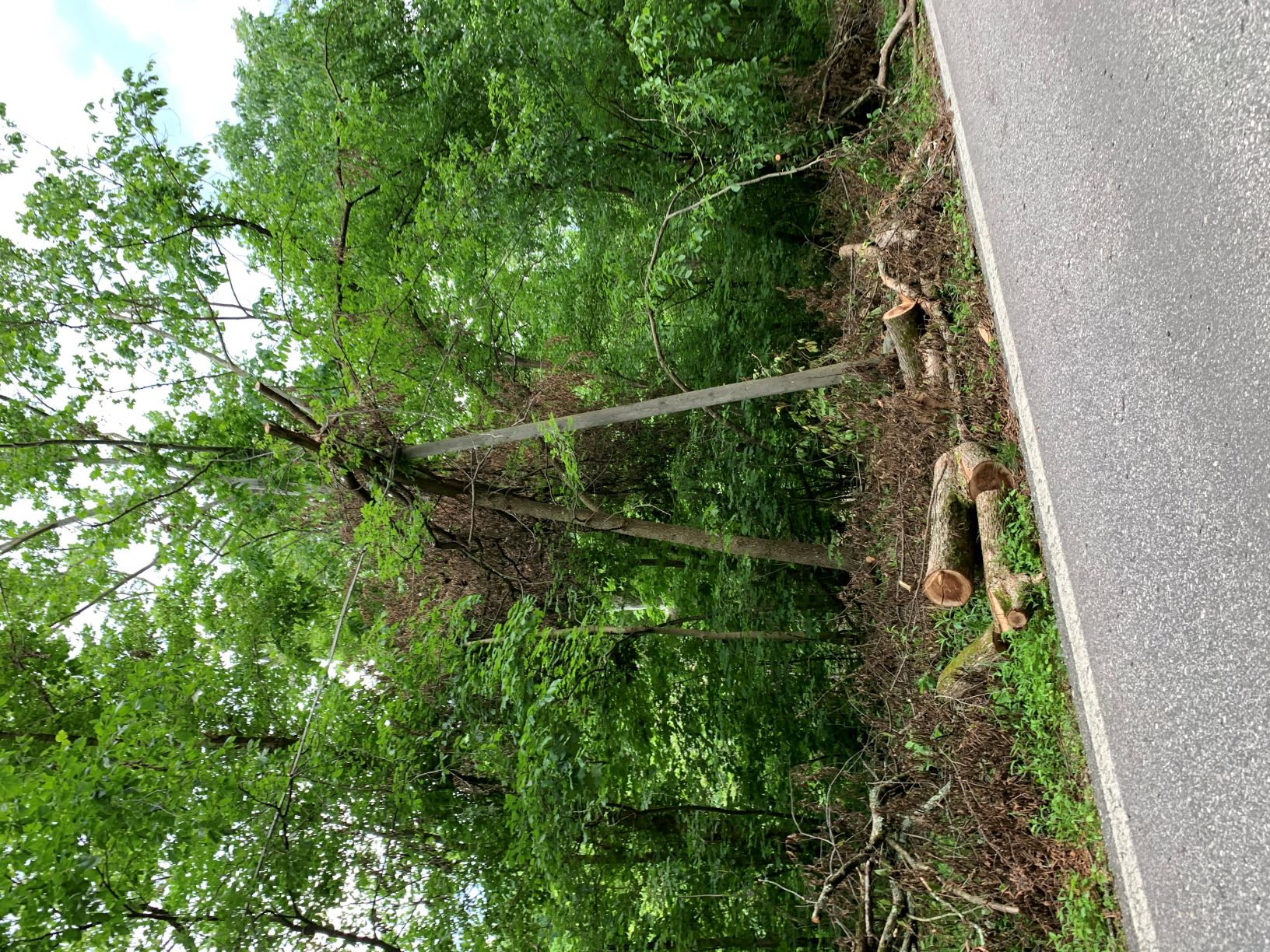

The pole in the pictures rotted off at the ground line. Someone simply hacked up the tree behind it and hung the pole in a "V" in the tree. The first picture was taken in May of 2020. Now nearly a year later the pole is still hanging in the tree. The second picture was taken last week.
There is also a ground block from the cable to the same ground rod that grounds the electrical service drop. It doesn't seem to affect anything though. My internet speed varies with the time of day, the weather, and anything that puts more people in front of their PC or TV. On a Sunday morning I usually get FAST speed. I have never seen a gigabit, but I have seen 950 Mbps several times. Friday evenings at 6PM, 250 Mbps is more like it. Maybe a bit less if it's raining or real cold.
The TV is a different story. There are several more poles that are standing because the cable is holding them up. They sway in the wind, and the TV picture pixelizes often. This confuses the DVR, so it gives up. Cramcast just swaps the DVR.....doesn't fix the problem, but causes Sherri to lose all her saved TV, so as they expected we don't call them. Maybe the DVR needs to meet the wall outlet.........

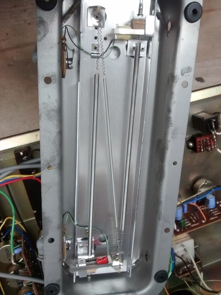

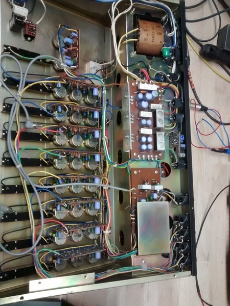

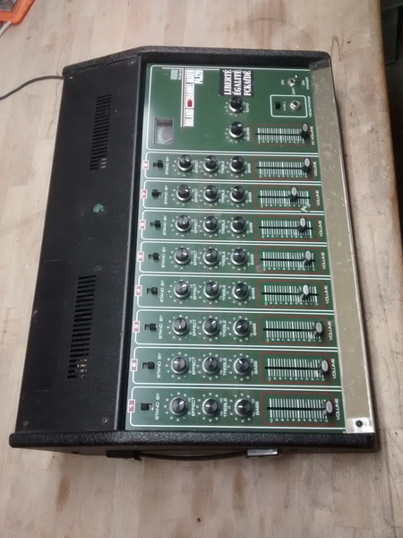

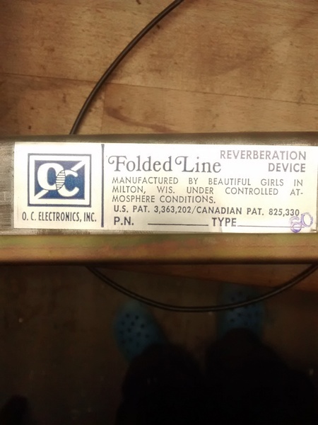

Yesterday a Roland PA-120 landed on my workbench.
The customer saying that reverb fails. So I did a quick check.
Not only was there no reverb but the sound was heavily distorted.
Further investigations revealed cross-over distortion with a step of several 100mV - obviously a matter of the power stage.
With no schematics available I reverse-engineered the power module.
This is what I found.
The output stage is Si-npn-darlington quasi-complementary design with two identical halves stacked as a halfbridge supplied by +-50 approx. These are driven by an audio transformer to provide phase splitting. Bias is set in each half wave by a fixed voltage divider calculated for 50V voltage drop. In other words, each half wave acts like a 50V-power zener diode.
There is no Bias adjust trimpot and no feedback-loop at all.
Thus output DC-offset is a matter of part matching and bias current strongly depends on supply voltage: There is a sweet-spot, below bias drops to zero, above bias explodes and lets the magic smoke emanate. Obviously this a flawed early design (dated 1975) that may have contributed to the bad reputation of SS-designs. All in all this is a very well built power-mixer, mechanical robust and with a well thought layout - but beyond repair.
