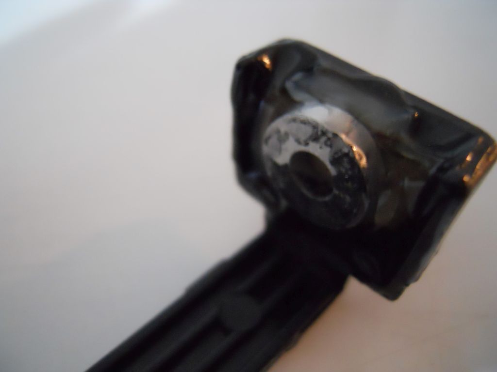

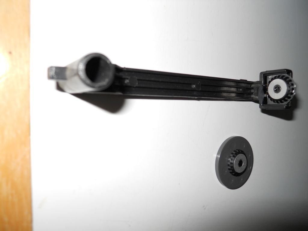

1 - Rear wiper arm on VW Polo.
Plastic arm had cracked around the alloy boss.
Figured it was old & maybe brittle & the freezing weather was the last straw.
Fitted replacement arm & at last half turn of spanner, crack, same thing happened!
Seller has replaced but not sure how I'm going to fit without a recurrence.
