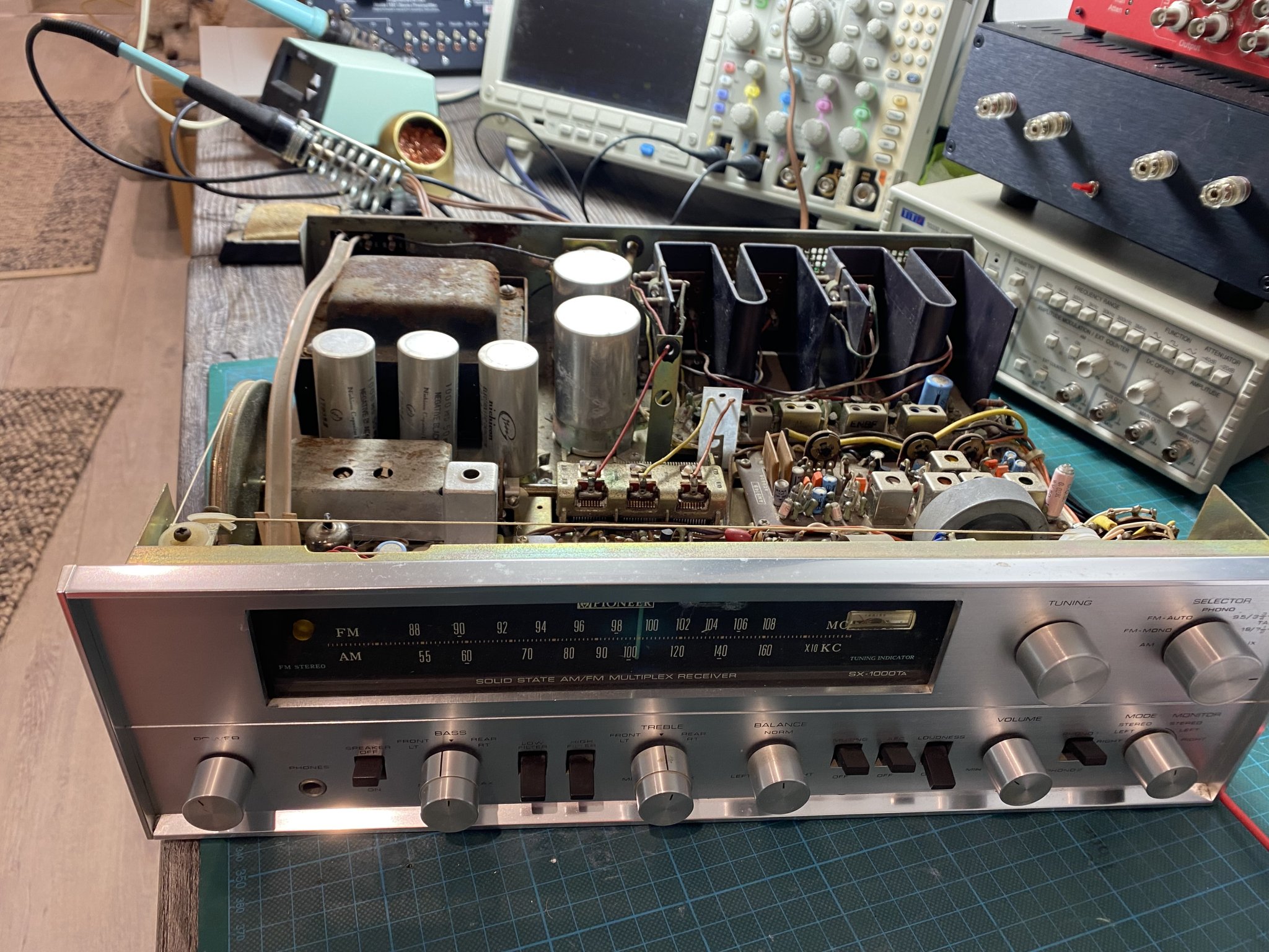

Working on this Pioneer SX-1000TA. I bought this for about 20 bucks 3 or 4 years ago from a guy at a garden centre (yes, garden centre - he had a room of old stuff at the back where this was). One of the channels had a blown OP transistor (2SC793) so I replaced all of them with MJ15024 since I didn't want there to be mixed devices in the OPS. One of the small signal devices in the power amp stage was also replaced and I replaced its complement in the other channel as well. Tonight I fed the thing from my WiiM into the AUX input- very smooth sound - absolutely fantastic. It is rated at 40W per channel.
The volume pot is not too scratchy via the aux input, but very bad on FM.
The FM tuner has a problem because the left channel is very distorted and at a lower volume than the right channel. I'm guessing its in the MPX circuit board - I'll try to tackle that tomorrow. AM was working when I tried it out about 2 years ago, but I'll tackle that after sorting the FM bit out. It has two phono inputs and a tape input as well - so after that I will check the phono bit out.
I'm really surprised at how quiet it is - not a trace of hum or hiss through the headphones and this is a 1966/67 design, so it is almost 60 years old. I understand they made this model for about 2 or 3 years before changing the FM tuner part (which is tube based on my one) for a solid-state one.
Anyway, it would be good to get this going. I've already told my wife I will hook it up to the Dali Oberons i the living room - it's a seriously cool-looking piece of retro gear IMV. Schematics are attached for those that are interested

Hi Bonsai,
What I have seen in Pioneer units like this are bad electrolytic caps, the odd bad transistor. This is a simple circuit as decoders go.
Look at C710/712 and Q704. You may possibly see a bad signal diode (connected to R716/717). Don't ignore the resistors, I have seen bad end caps and things like that too.
Good luck! Let us know.
Thanks - I was looking at the OA79s and one of them has gone leaky. I can't get OA79s but ordered some OA91s to try. I checked the caps you mention (there's 4 in total in the OPS the MPX) and they look ok, but maybe I should just replace them. The voltages around Q704 and Q705 look good and they test out ok in diode mode. I set the separation pot on the back panel to mid travel for the time being - it hasn't made any difference.
The unit is tuning in very well, but its very distorted on the left channel. The amplifier section is working perfectly now.

Hi Bonsai,
Any germanium signal diode will work fine there. I use 1N34A or other Japanese diodes I have from years ago. Voltages and currents are very low, check for lower leakage currents. I try to match the forward junction drop. So, all four of these.
Replace the capacitors as a group. On old Pioneer units (and many others), they go open or get leaky. They aren't worth much so may as well.
