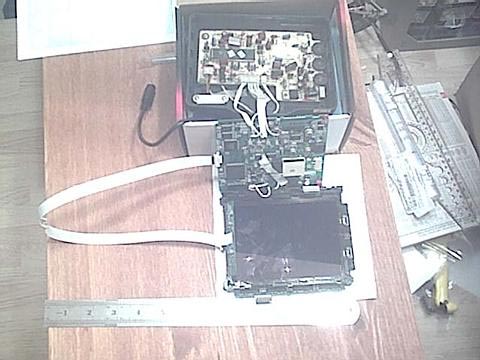

cable extension of the good old days
here you see (i hope so at least) that i used a longer cable and a connector between the short original cable and the longer new one: you see it is about 8 inches long FAR TOO LANG FOR THE SIGNAL TO GO THROUGH!!!!!
the panel in this case is 5.6"
