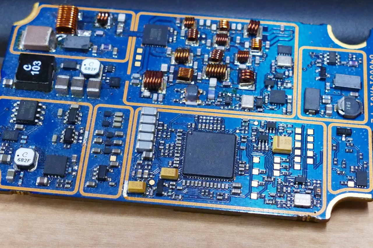

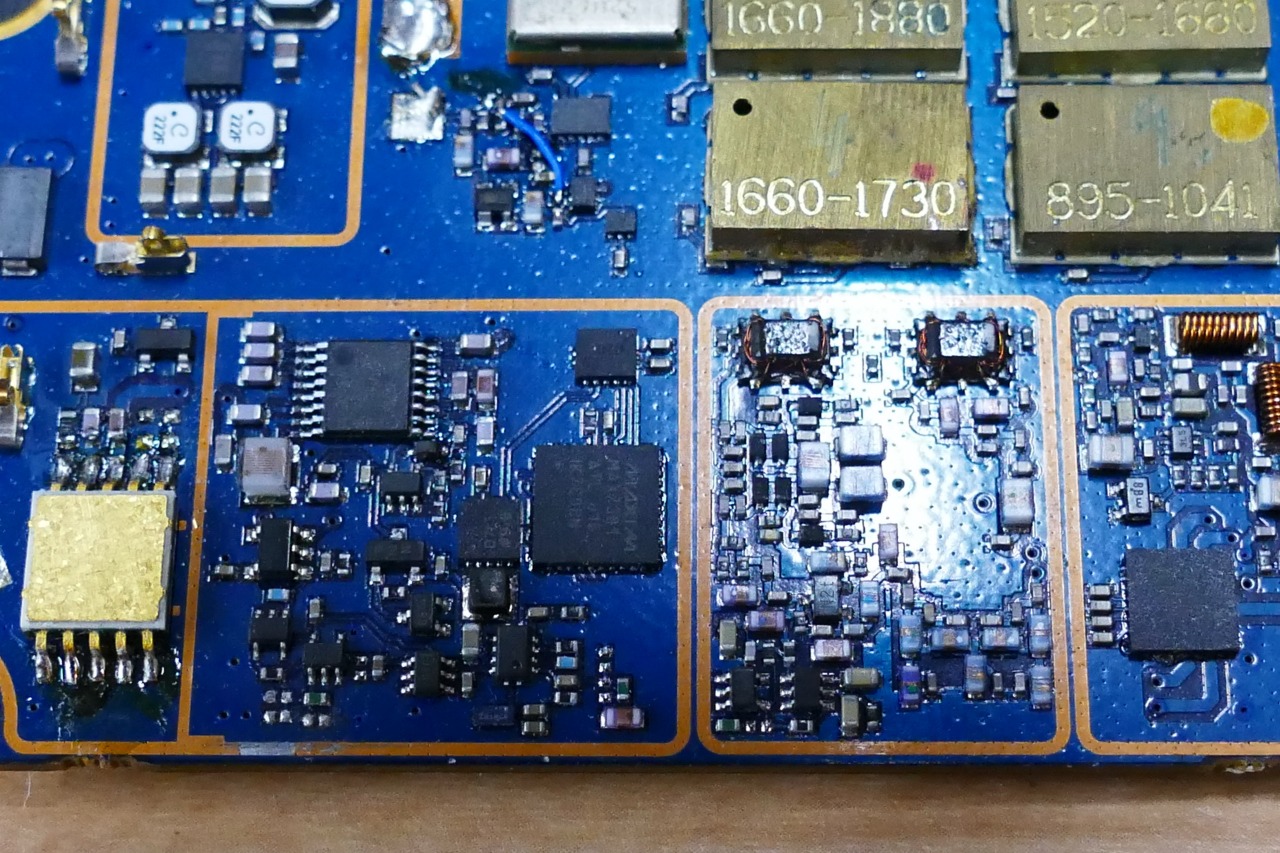

My PCB layout work at Motorola was all on high dollar stuff from Mentor Graphics and Cadence where I did stuff like this 5 sq. inch 10 layer HDI RF board that holds over 500 components. My biggest issue was remembering which commands and shortcuts go with which layout package since for a few years I was actively using all three.
I don't plan on ever doing high density stuff again but reasonable SMD, mixed TH and SMD, and good old TH tube amp boards will be in my future. I need to pick one good tool that will suit me for the rest of my life and learn it, but for now I'm still using Eagle 5.11 since it cost's me nothing and does most of what I need. 5.11 will not read any library created in any Eagle version after 6.x and Autodesk seems to have disabled my workaround, so the time to start over is near.

The board seen in post #31 is the FIRST prototype of a high tier police walkie talkie that is now selling, for several K$ each. It works on 4 different frequency bands so it can talk to any other police officer in North America during a large scale emergency. The transmitter runs a single ended GaN fet in class AB for high efficiency. This generates some THD, which is illegal so there is a switched bank of low pass filters (the large air wound coils) to remove the harmonics before feeding the power to the antenna. All harmonics must be 80 dB below the desired signal to be legal.....and you thought home HiFi is clean.
In the first picture the parts in the lower left box are part of the power supply, with the boost inductor, diode, and caps outside the box. The box above that contains some of the transmitter. The GaN fet in on the other side. The largest coil is the drain (parafeed) choke. This feeds the black chip in the box to the right through a small coil and some impedance matching parts (the OPT). The chip is a 4 port switch that selects one of 4 filters which are feeding another 4 port switch on the other side of the board. The large chip in the large box on the lower right is a custom designed CMOS RF chip that our group designed. The purpose of this board was to prove to management that the chip was worth the two years and over one million dollars they spent on it. I had the local PD calls playing on a board like this one when the Chicago bosses came to see it. My prototypes tended to work well, even the early ones like this. That's why I lasted for 41 years in the same company.
The shiny gold backed square in the lower left box in the second picture is the GaN FET that can make 10 watts of RF power from 100 MHz to over 2 GHz. The flying piece of wire wrap wire bypasses the second stage of a two stage buffer amp that was deemed unnecessary after testing. The 4 brass cans each contain two VCO's to generate all the necessary frequencies needed for the radio. Most of the smaller SMD coils in the box below the VCO's are part of the receiver's filtering. These are needed to keep unwanted signals out of the receiver. TV transmitters use frequencies very close to police radio frequencies. TV transmitters have a radiated power level of up to a MEGAWATT. The Miami Florida antenna farm has 12 of these 1 MW transmitters and some lower powered stuff. Yes, I got away with requesting company funds to test our radios at my favorite worst case test site, the upper deck of the stadium used for the Miami Dolphins and at the time the Miami Marlins. It is 1 mile west of the tower farm.
The upper management ate the megabuck design costs for integrating much of a complex radio into the big chip seen in this board. They then funded the development of a second chip to integrate the 8 VCO's and other frequency synthesizer circuitry. I left the company before the second chip was finished. When the company offered me a box full of money to leave, I took the money and ran.....1200 miles away.
