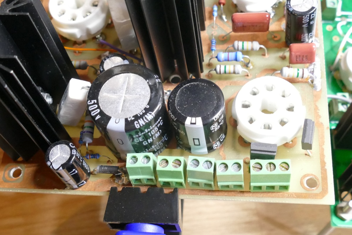

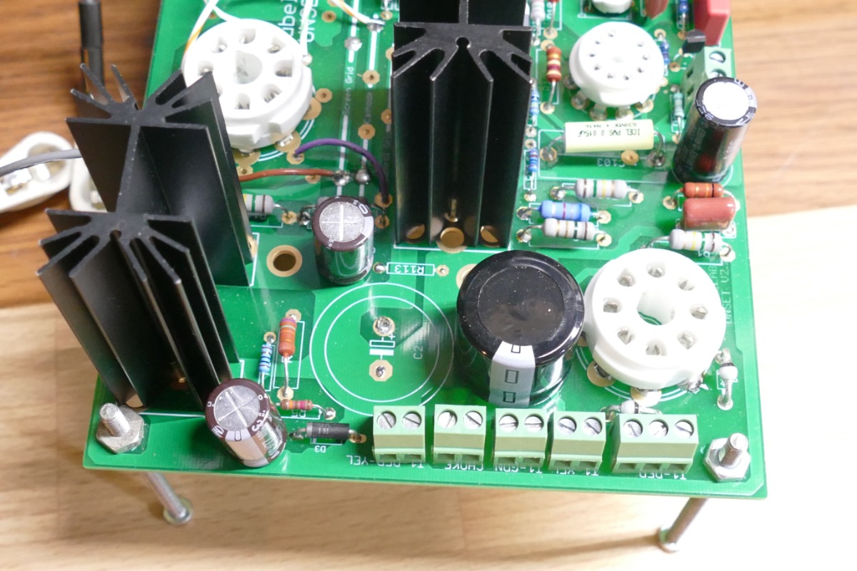

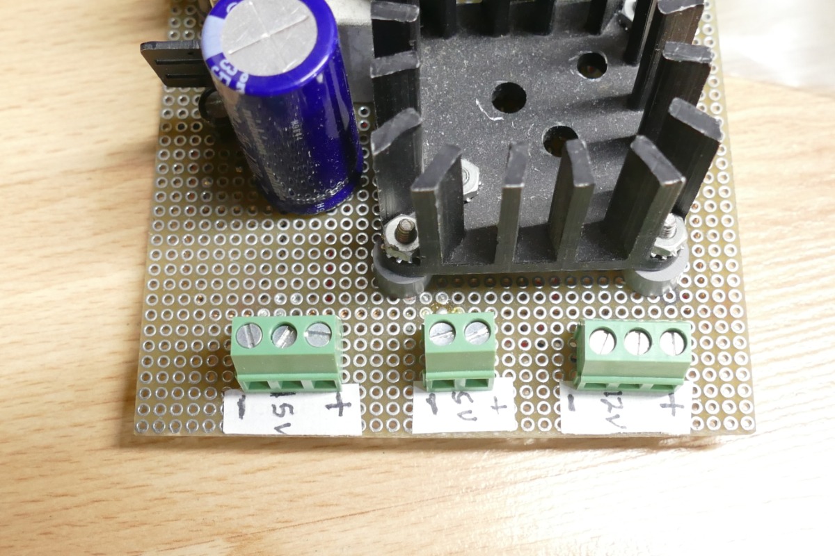

I have been making vacuum tube prototype boards for 20+ years. I use the green connectors seen here. The pins are on 200 mil centers so they can be used on perf board too. They have seen 5 amps or more of heater current if the screws are tight. If stuffing more than 350 volts into one, leave an unused pin between any two terminals with more than 350 volts between them. They are used in my finished boards too. There is an unused pin between the HV secondary leads on the power transformer in the amp boards since they see 750 volts or more. The three pin connector has the middle pin unused. To connect two boards directly together I stick short pieces of #14 wire into each active pin, tighten the screws, then insert the whole "row of nails" into a matching set of connectors on the second board.
I get them cheap here. TER 202 (2 pin) and TER203 (3 pin) can be snapped together to make any length except a single pin. Digikey and Mouser have similar connectors for more money.
