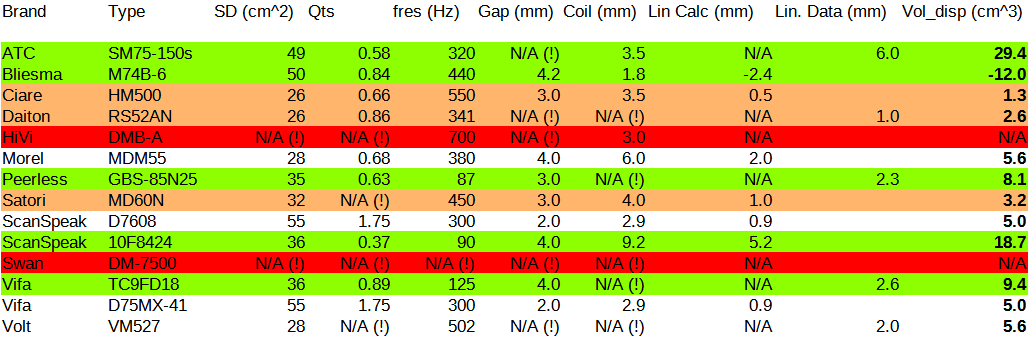

Also I was heavily disappointed by the data of the so long highly hyped (over a year ...) Satori MD60N before it finally got released.
S.Linkwitz produced a nice spreadsheet to evaluate the attainable SPL in dB related to the Frequency, to SD and to Xmax.
https://linkwitzlab.com/spl_max1.xlsThe results will give a nice hint about how low and how loud you may go with a given driver.
Therefore, I compiled the relevant data of all previously mentionned drivers in this thread. Look at, look at ...
HiVi and Swan HiVi drop out due to lousy and/or none publised data. If a manufacturer is not able to publish data, then forget about it.
Ciare, Daiton and Satori seem rather suited for silentspeakers than for loudspeakers. Thanks, no, not really ...
Morel and Scan-Speak (D7608), Vifa (D75MX) and Volt are already better, but really do not excel in terms of volume displacement capacity. Negatively out of this bunch Volt does not provide any Q-related data and has the highest fres of this batch.
ATC, BliesMa, Peerless, ScanSpeak (10F) and Vifa (TC9F) finally seem to make a good job. Bliesma would be my favorite, it has an underhung coil and very decent overall parameters. The negative result for the volume displacement value of this Bliesma is a math artefact because of the underung voice coil. But this beryllium dome also comes along with a ridiculously high price at the sub-1k$-border. ATC seems unobtainium. ScanSpeak and Vifa are no domes. Peerless? Peerless seems interesting also.
So now ... what are the best options for a midrange dome driver ...
To my gusto Bliesma. Either the Bliesma beryllium driver in a cost-no-object project, or then it's more reasonably priced fabric or silk/fabric or Mg/Al dome sibling, which has not been mentionned in this thread before. Personally, I would hands down go for the Mg/Al M74A version if the dynamic measurements were ok. We will see. Maybe. As you now know, there has already been a disappointment in terms of hyped midrange domes ...
