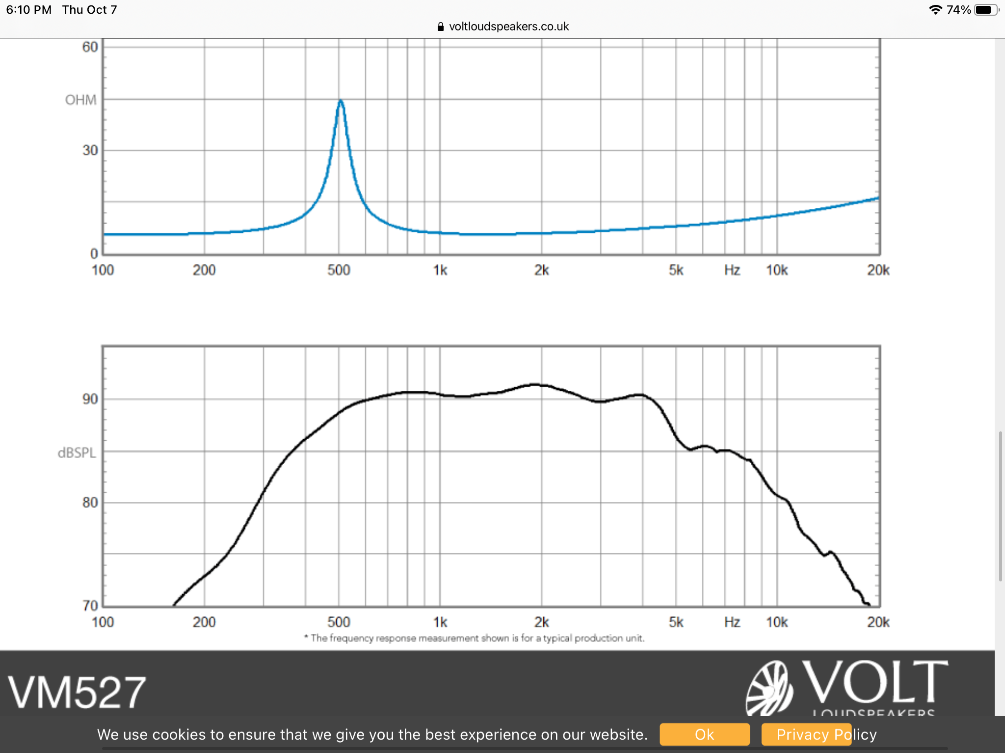

I forgot about this thread and found it today doing a search for a dome mid for 4-way. It seems i have been thinking about it before 🙂
The thing is i have never heard a dome mid before. Some people seem a bit fanatic of what they can produce. When i started the thread i was searching for a dome for a 3-way, so would have needed as wide bandwidth as possible. But if one keeps the band width between 1k to ~3k, is it possible to get good results from the SS mid?
Within this limited bandwidth, does any of the other cheaper and smaller domes perform better? I am inclined to the use of low order filters, so the driver should preferably be free of severe break up.
The morel ET dome seems interesting, it is right at the limit of what i think is reasonable to pay also. So could be an option. Is there a large difference between this and the cheaper Morel dome? I guess the ET is the better one?
