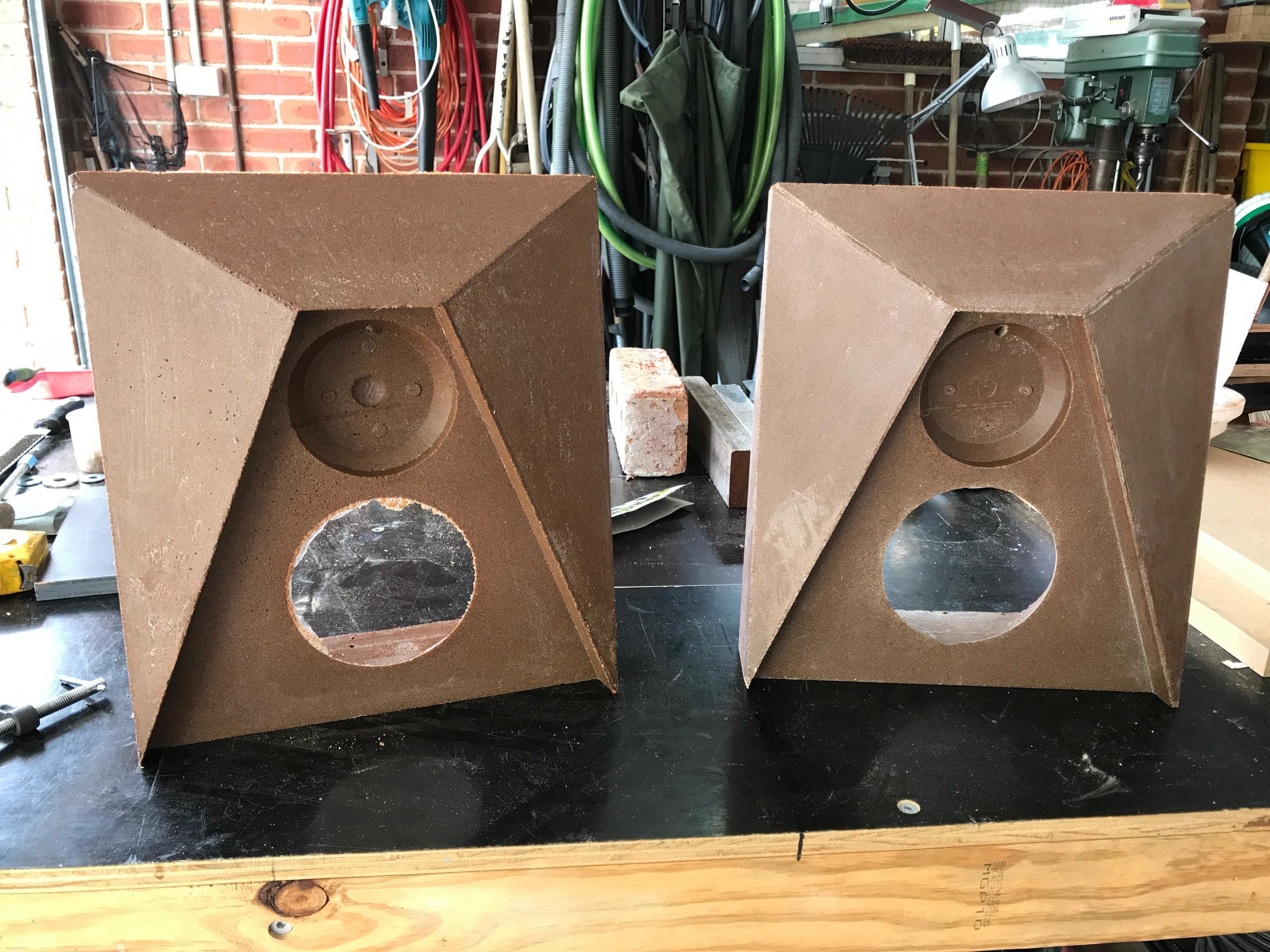

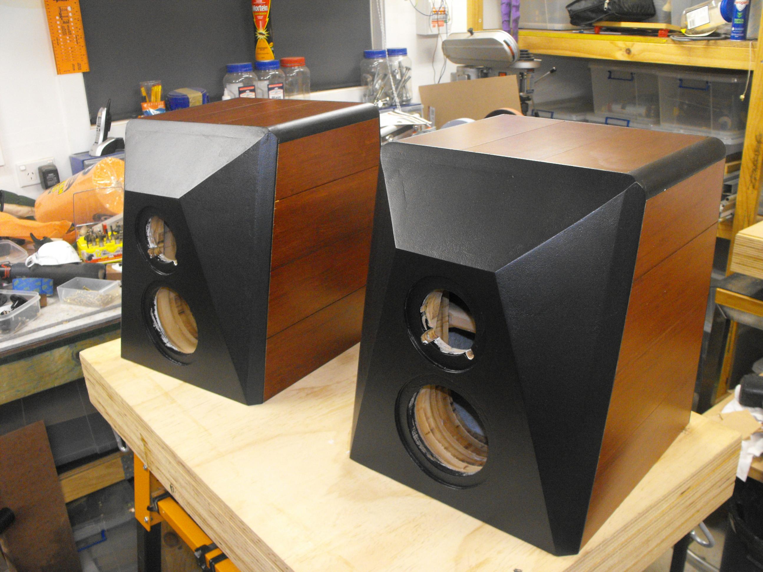

What are some good example of baffle design to improve diffraction
Yea, I would say that's true or maybe not mixed, perhaps sub-optimal. I try and completely absorb the rear wall reflections (behind the speakers). This seems to improve the imaging quite a bit. Rear wall reflections, coming from an axis close to that of the sound source, will be quite significant psychoacoustically. Best not to have them.
"Diffraction, which occurs at every sharp cabinet boundary, creates delayed, reverse-phase phantom sources that interfere with the direct sound from the actual driver. These secondary phantom images create significant ripples in the midrange response (up to 6 dB) and create delayed sounds which disrupt the timing cues necessary to perceive stereo images. These dispersion problems are audible as room-dependent colorations, coarse midrange, diffuse stereo, and a "detenting" effect that pulls images in towards the loudspeaker cabinets."
The Art of Speaker Design
Spica
I'd think the concept is likely sound, but the density and ability to transmit sound aren't the same in the felt I had as were needed to absorb sound waves all that much (which would be a narrow target to hit in the material science, I imagine). I was surprised, expected it to help a lot, but it really didin't. I suspect something fibrous but less densely packed would be in the right direction.
