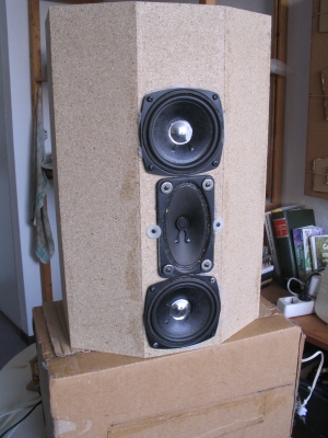

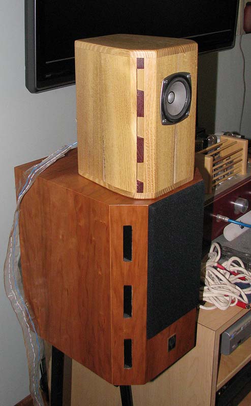

https://projectgallery.parts-express.com/home-audio-video/eliasound-m1/
this is cool.
mounting a speaker to a tall cylinder.
Not as good as a ball, but I would think really good.
Probably make it 6' tall so as not to worry about diffraction.
Think I would do same but as a satellite with a separate bass module.
12" pvc......................
I found 12" x 5' long shedule 40 pvc for $273.
Baffle step at 4560/12 = 380hz, maybe 3-6db down depending on room / distance to front wall, etc.
down even more at 190hz also.
I think patrick bateman said something about doing something similar and it sounding really good.
