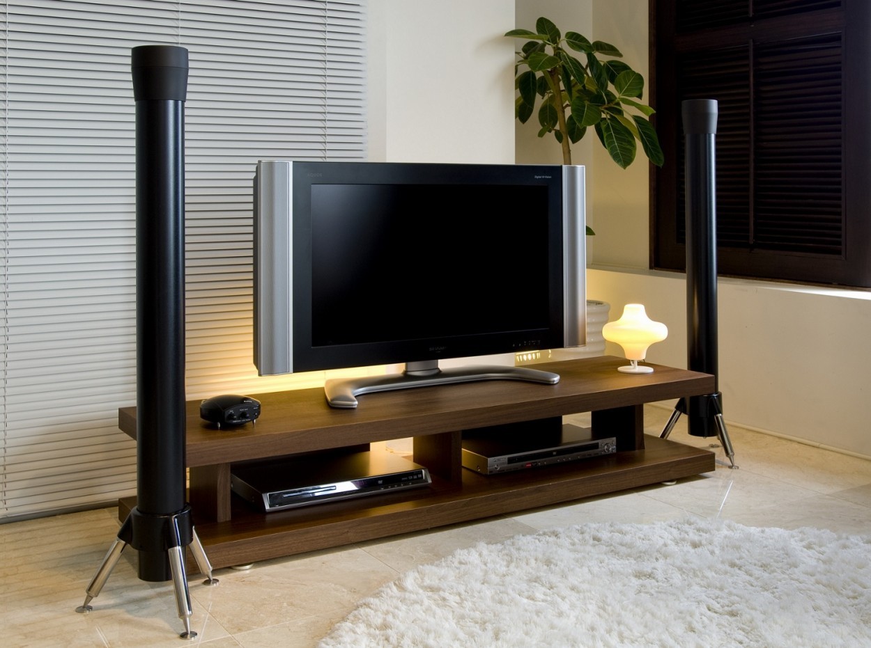

Reading about LXmini woofer reminded me of a design I had written to You about a couple of years ago (after that You posted a link on the Constant directivity loudspeaker designs page) ie. Yoshii9 of Time Domain Japan:
TIMEDOMAIN
I am aware that You use the up-firing woofer only below 1 kHz while Mr Yoshii uses a small driver fullrange but what do You think of it?
What possible advantages/disadvantages?
Can the small fullrange be replaced by a bigger up-firing coaxial speaker for better results? How could this approach possibly compare to Pluto/LXmini approach?

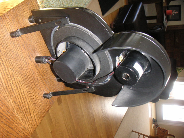

another similar design: Trevor Marshall - Ground Effect Omnidirectional HiFi Loudspeakers
and yet another: Omuni Omnidirectional Loudspeakers Announced – witchdoctor.co.nz
Home - OMUNI AUDIO
Home - OMUNI AUDIO
This kind of upwards radiating speakers don't give hardly any direct radiation above 2-3kHz. Tonal balance must be quite "smooth an mellow" if no equalization is used. That's why Linkwitz's Pluto an LXMini have vertically positioned tweeters that must be pointed towards the listener.

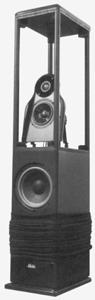

Old near-wall speakers like Sonab OA and Larsen had/have several tweeters to spread out high frequencies. They were originally designed for mono sound/single unit - they spray the music in a room quite well...
Larsen HiFi 8 loudspeaker | Stereophile.com
Speakers - CarlssonPlanet
I have a pair of these OA-14 at my summer cabin!

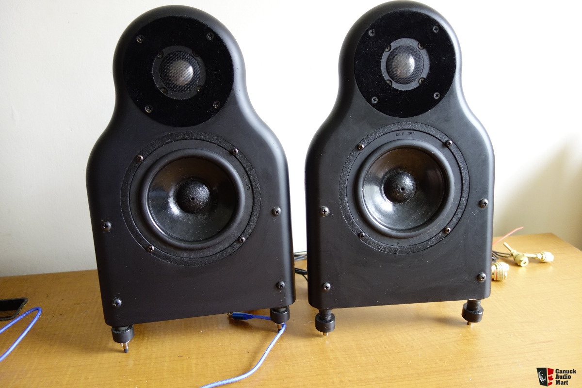

and flat coaxials because diffraction is a major and inherent problem in coaxials
not neccesarily flat - here is a minimum diffraction coaxial proposed by Genelec:
