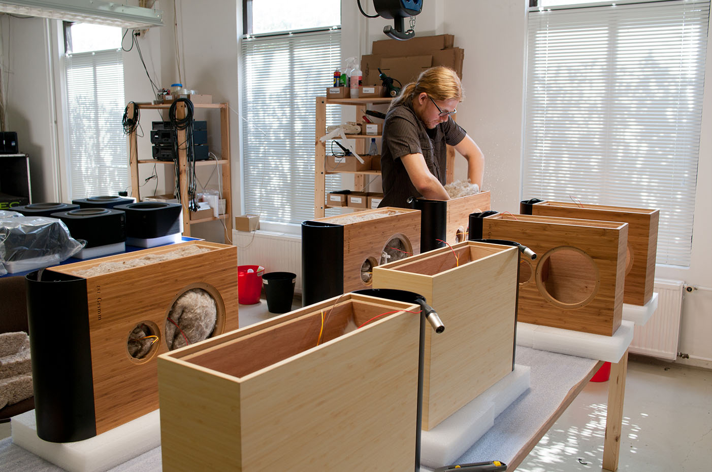

Grimm Audio LS1 has the positioning of the tweeter more central to the relatively wide baffle and beneath the mid so that a curved edge nearest the tweeter is more aesthetically pleasing on the bottom rather if it were on the top.

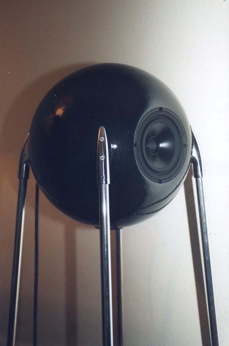

Ive seen a few examles recently of full range drivers in salad bowl spheres, is this a preferred option?
And it's filled with real wool!
Yes, if the range is full enough and the sphere large enough.
Sputnik from 1997:

But with a sphere enclosure, you have 1 severe resonance peak.
Unless really large sphere, that standing wave is high in frequency and quite easy to absorb.
