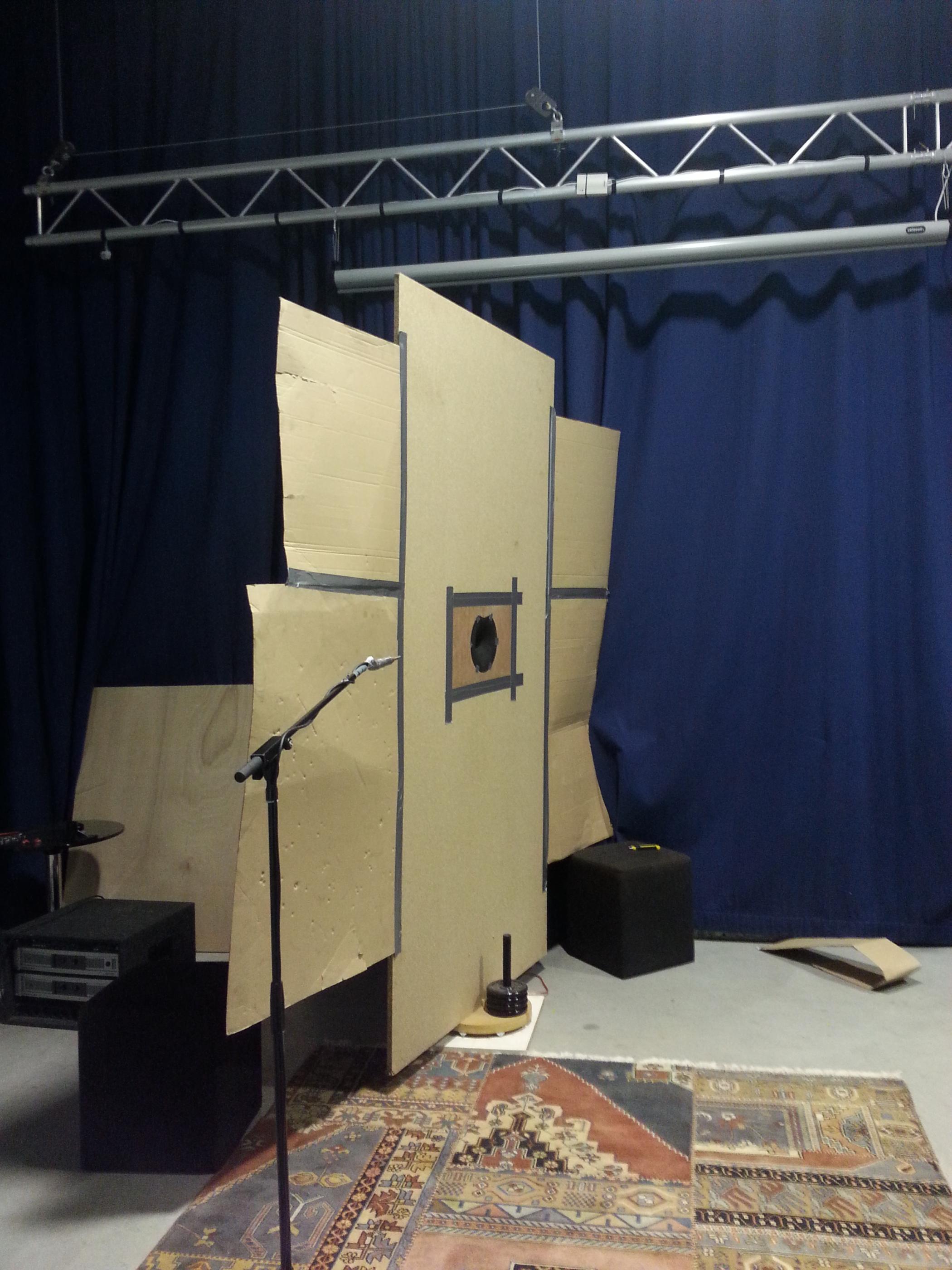

When I worked on the baffle design for the 8c I took infinite baffle measurements as a reference point. I looked at frequency response, directivity and the Energy Time Curve. In the ETC irregularities are easier to spot than in an impulse response.
A tip: make sure you are not focusing on very small reflections that happen close to the microphone, instead of baffle edges!
