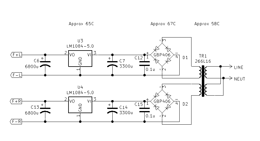

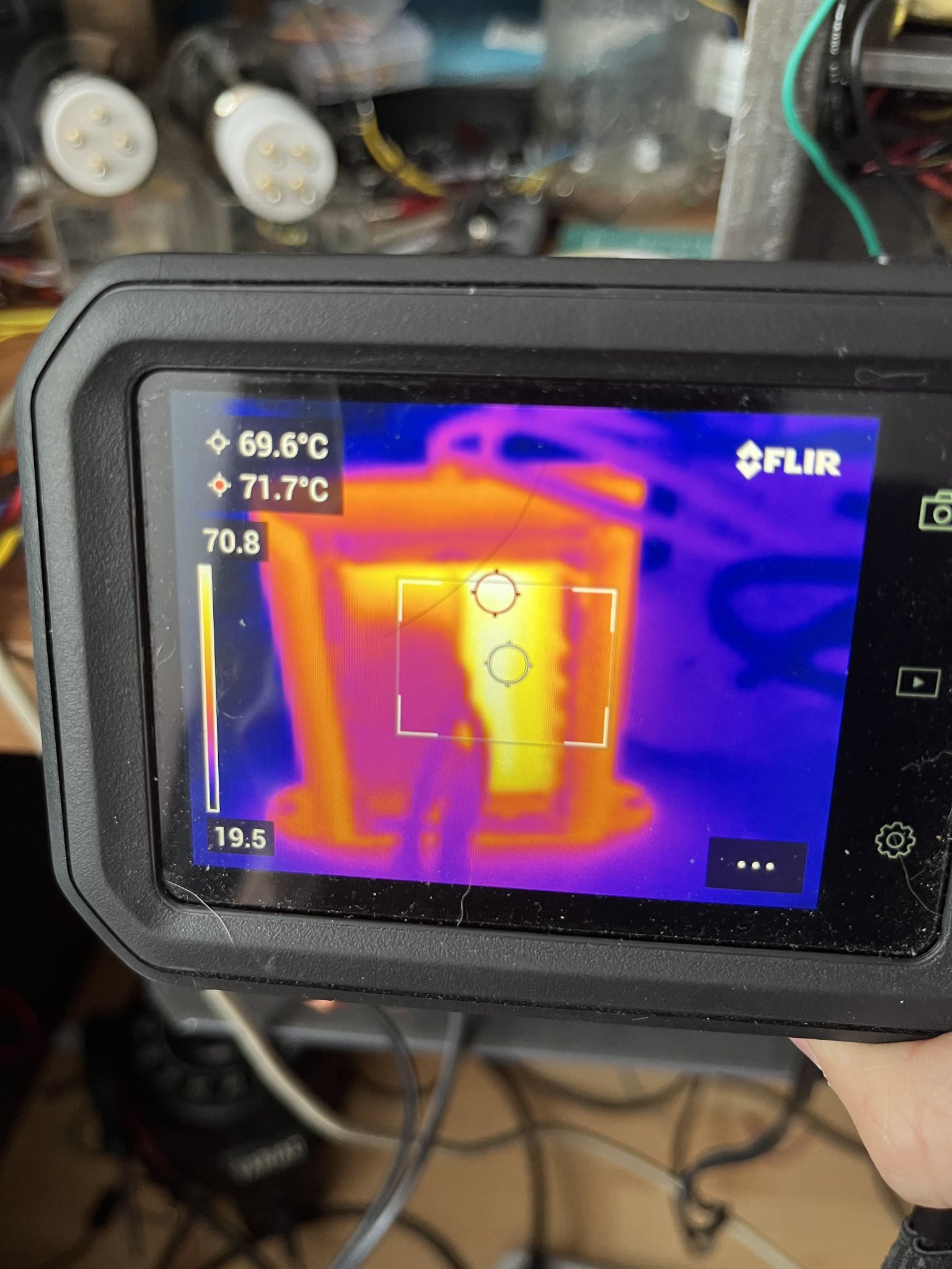

Back to the filament supply… i’ve switched things up to a regular LDO (LM1084it-5.0) instead of my “zener shunt” and swapped out the 266LA12 for a 266K18 transformer and TBH it’s not running much cooler. The Bridge is maybe a touch cooler at 52 instead of 60s, but the filament transformer (266K18) is running at 70 degrees C… i’ve tried dropping the primary voltage with a variac to just above point where the regulator is able to do its thing but not much change in bridge heat, although LDO is obviously dissipating less. I’m hoping a 266L16 which is 35VA instead of 27VA of the prior trafos, and closer in voltage to what the whole thing appears to need - thus less to dissipate. because of my space constraints, I might even consider a switching setup just to keep things cool.

Someone correct me if I'm wrong, but you might try reducing the input cap on the filament supply to 6800 or 4700uF. The 10,000uF cap might be increasing the heat of the transformer and bridge.

Dear efm7, please draw a complete and detailed supply schematic, including how the secondaries on hammond's transformers are connected.
I tried the experiment suggested here - dropping the first filter cap down from 10,000u to 3,300u (which is what I had on hand) the smaller cap still allows for a steady 5v…. however the downstream caps (C6, C13) are still quite large and seems a bit silly now… but none of the cap swapping made much of a difference, the biggest change was as observed in putting in a more appropriate transformer - switched Hammond 266K18 (27VA) for 266L16 (35VA).. which doesn’t struggle as much and has less for the LDO to burn off.
I think the other issue is:
- small surface area bridge (GBP406)
- bridge Vf not as low as it could be (1v as opposed the 0.9v that’s available)
- compromised thermal design (on the vertical part of a thin interior L-bracket instead of directly against an exterior wall of the chassis.

Again, I don't work much with SS components but I think that bridge is too small. I used an old-style square-bottom, epoxy-embedded 50A bridge for my Aikido experiments (four 6SN7s) and it got pretty warm. But I am not much of a technician so I can only offer anecdotal advice.
